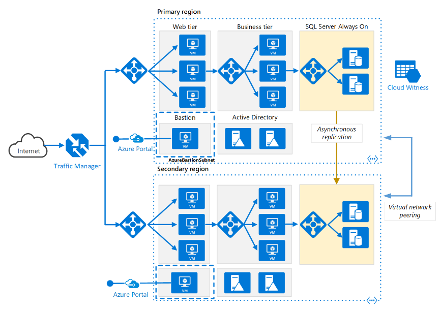

Hi i have two azure regions on wich i have deployed for inbound a load balancer that load balance traffic to a backend of 3d party firewalls and then a in the back an internal lb. If i would to load balance between the regions can i put in front of both region a traffic manager? so i should have region 1 load balancer-----3d party firewall ------ internal load balancer--------app or service published traffic manager region 2 load balancer-----3d party firewall ------ internal load balancer--------app or service published thanks

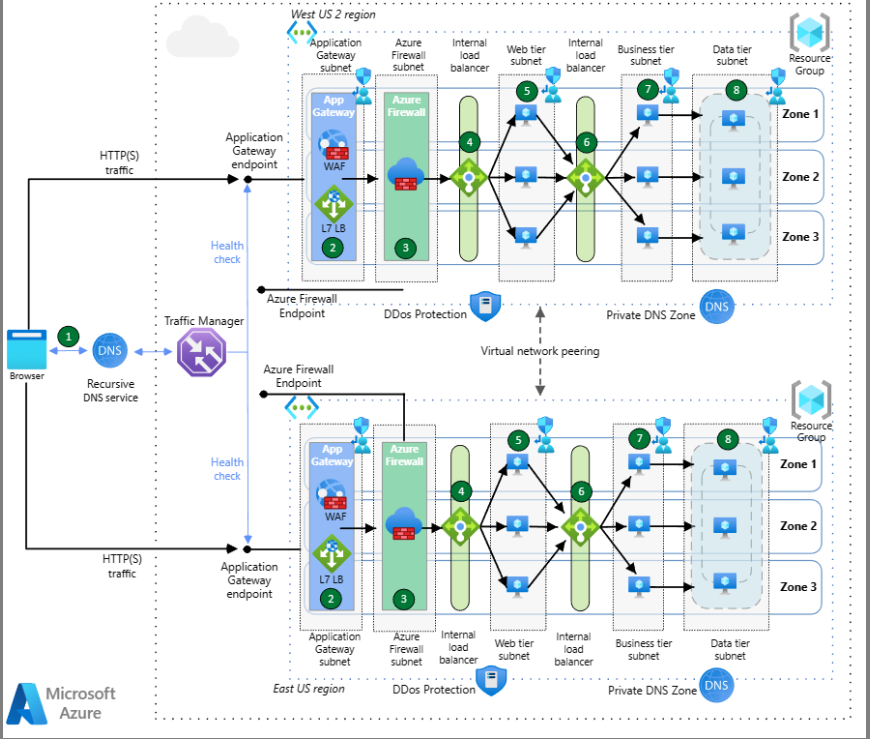

    You can refer the below architectures which shows Traffic manager with load balancer setup:
    https://learn.microsoft.com/en-us/azure/architecture/reference-architectures/n-tier/multi-region-sql-server
    https://learn.microsoft.com/en-us/azure/architecture/example-scenario/infrastructure/multi-tier-app-disaster-recovery
