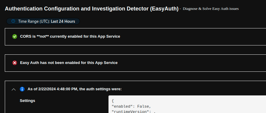

We have a Flask application deployed on Linux Azure App Service, Plan P1v2. The authorization (EasyAuth) is not enabled.
We do POST requests with a payload => ~8kb and the reposes are a 500 instead an expected 401 or 400. Inspecting the log of our application it returns the proper code. Inspecting other logs we notice the EasyAuth logs, they report the following error:enter image description here So even if EasyAuth is disabled the EasyAuth middleware is forwarding our requests and for some reasons it is crashing returning 500.
How we could disable definitely EasyAuth middleware?
Details

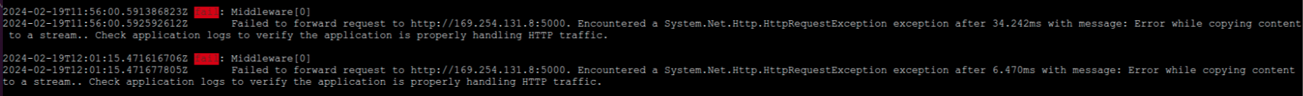

Inspecting with Diagnose and solve problems tool the EasyAuth section report the following stack trace.
The problem seems that the Flask application answer too fast before the payload is completely streamed from the EasyAut middleware.

    @CAMPOLMI-EXT Oscar I understand you are receiving 500 errors and are concerned about resolving them.
    The last time I saw this error was in December and the customer was indeed using EasyAuth. The solution was to turn off EasyAuth. The difference though is that the customer was having issues with files larger than 1GB, which is different than your experience so this might not be the solution.
    The other time I saw this error the customer needed to expand their timeout to be beyond 30 seconds in their gunicorn.conf.py file. I wonder if this might be part of your issue since you said the response is coming in too quickly.
    Can you please check any timeout values for your application that you might think need adjusting? Let us know the outcome and if you need further assistance, we can help you.
