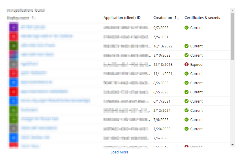

  1. RobinCM 91 Reputation points
    2024-10-25T17:32:57.8433333+00:00
    Take a look at this: Recommendation to renew expiring application credentials - Microsoft Entra ID | Microsoft Learn
    I had an email a few weeks ago telling me that I had an application credential expiring. When you click the link in the email it takes you to a page on the Azure portal which lists the resource name and ID.
    For info I've got E5 licences.
