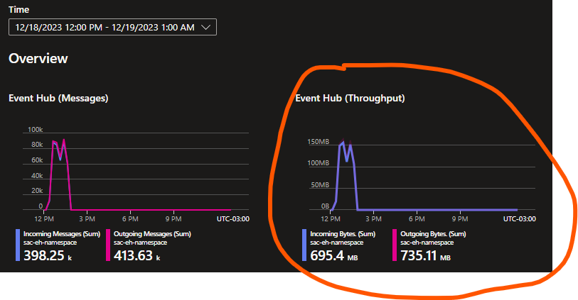

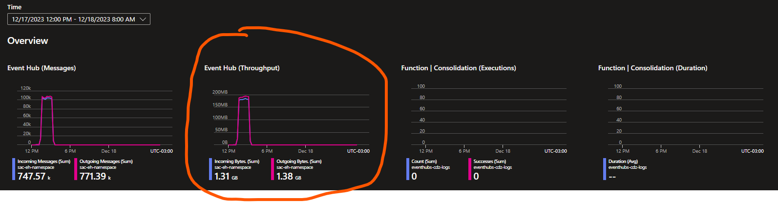

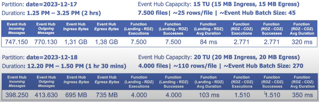

In the first test, I uploaded 7.500 CSV files containing aprox 25 rows each. According to the workbook, this traslated to 1,31 GB ingress on Event Hub. In the second experiment, I uploaded 4.000 CSV files of 110 rows aprox each that represents more or less 695 MB ingress, This is the workbook for the first case User's image
This the second case User's image

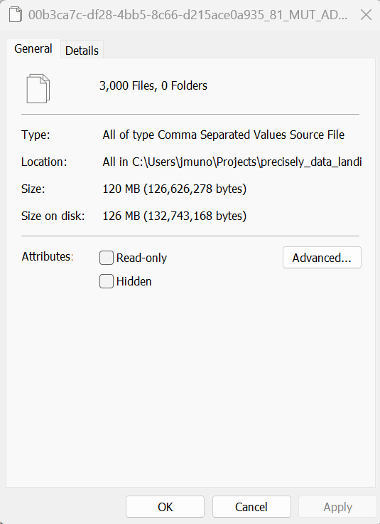

    Yes. However, I ran and interesting experiment. This are the parameters:
    • 3.000 CSV files, with a toal size of 126 MB on disk (120 MB "not on disk", I don't how to express this) User's image

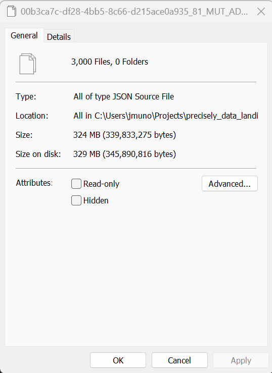

    • The size of the CSV files in JSON format in my local computer are 324 MB User's image These are the metrics:

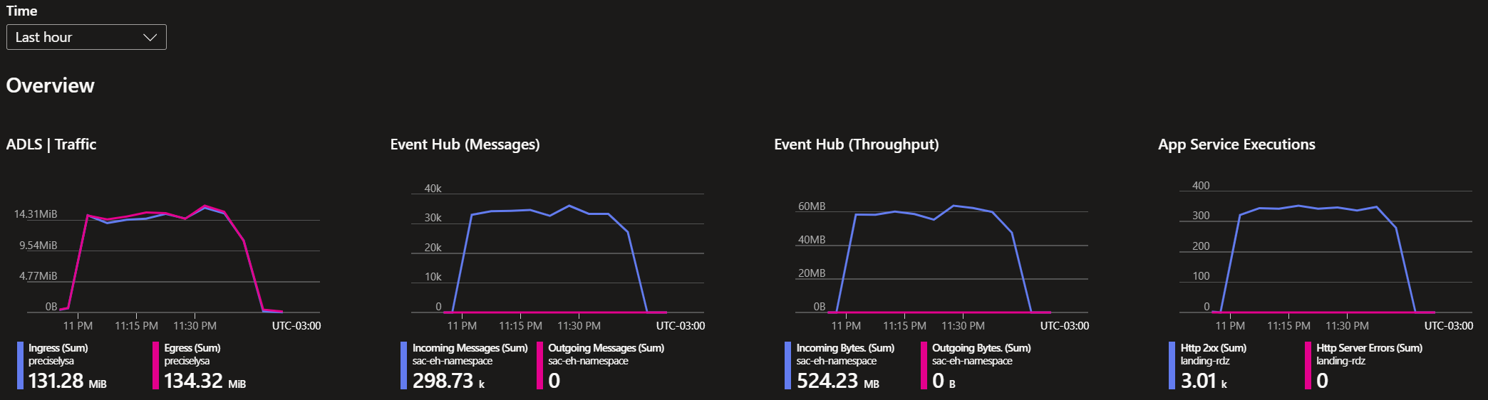

    • 131 MB enters to ADLS. Compared to thos 126 MB, the difference is negligible. However, I would like to know where those 5 MB went
    • After the Function transforming to JSON, 524 MB entered to Event hub. There is almost a difference of 200MB between my local calculation and the Event hub metric.
    I can blame that difference to the transformacion from CSV to JSON, since I add some fields to the resulting JSON.
