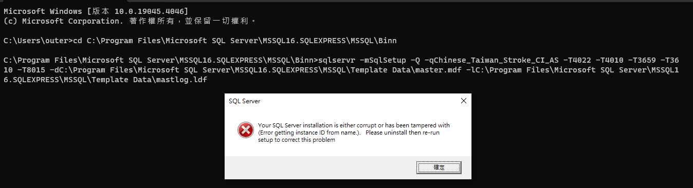

I am trying to install SQL2022-SSEI-Expr, but it keeps coming up with -2147467259. I have already made the attempt:
  1. disable the firewall and make sure the SQL related port is on.
  2. Delete the SQL related registry options from the registry. Below is the code for my error (one of the times), I have installed it about 30-40 times in total. I am also attaching the Detail.txt of the error message Detail.txt Summary_DESKTOP-R9NT1U7_20240224_184752.txt I really need your help, thank you for your help! The error message is translated, the original text is in Chinese. Detailed results. Feature: Database Engine Service Status: Failed Reason for failure: An error occurred during the installation process for the feature. Next Step: Use the following information to resolve the error, uninstall the feature, and then re-run the installer. Component name: SQL Server Database Engine Service running individual feature Component error code: 0x80004005 Error description: The service does not respond to startup or control requests in a timely manner. Error help link: https://go.microsoft.com/fwlink?LinkId=20476&ProdName=Microsoft+SQL+Server&EvtSrc=setup.rll&EvtID=50000&ProdVer=16.0 .1000.6&EvtType=0xDC112D1C%400xDC80C325&EvtType=0xDC112D1C%400xDC80C325
