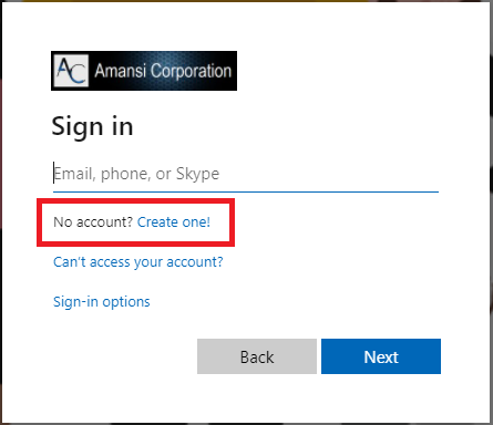

    To see the experience, you can try accessing my test application https://crafts.cloud365.in and on the sign in page click on create account link highlighted below:
