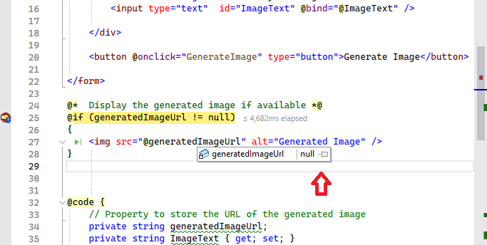

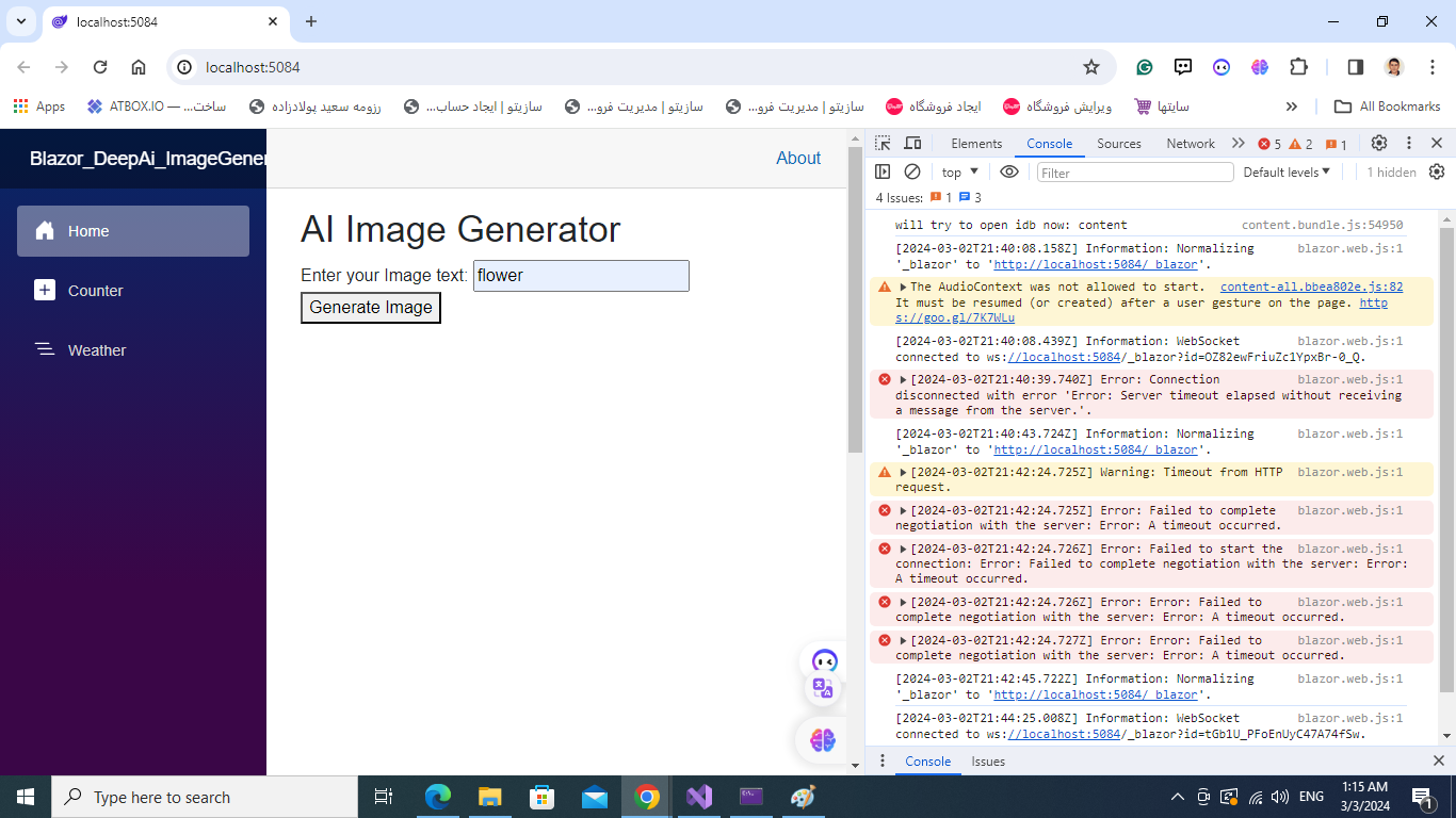

  2. Saeed Pooladzadeh 241 Reputation points
    2024-03-02T10:24:43.1066667+00:00
    Could you get into GenerateImage() method when you debug?Did you reveive the url successfully?Could you see the image when you input the url you reveived in browser?
    I mean when I press the button no image appears. And the generatedImageUrl is null.
