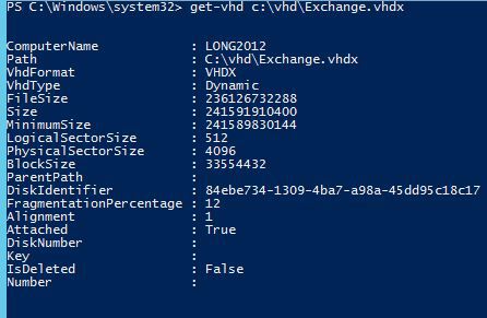

Server 2012R2 STD (Hyper-V system) Exchange Server2013 role I am trying to free up space on the Hyper-V Host system. I work the process correctly but th VM comes back with "no space". I ran defrag - OK Here is the process stream: Host system Get-VHD file sizing

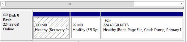

VM partition Disk_Mgmt partion size

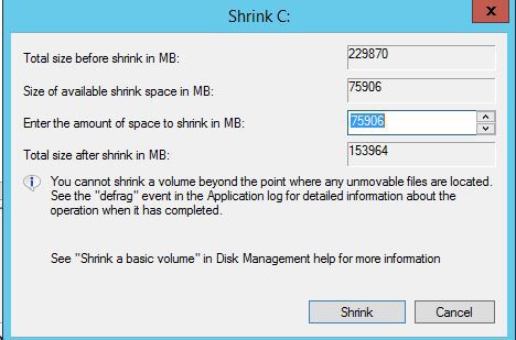

Shrink Volume reporting: Shrink Volume_initial

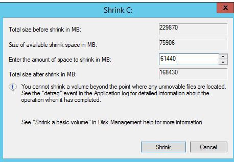

Set shrink size to 60GB. Shrink Volume_60 GB
