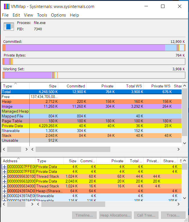

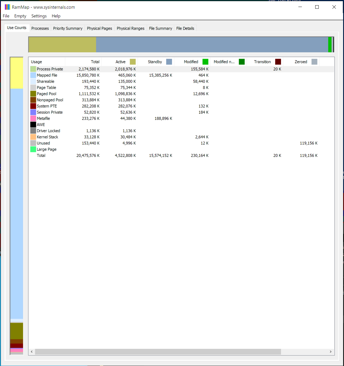

I'd like Windows developers to look at the issue reported here: https://internals.rust-lang.org/t/high-memory-usage-on-random-file-reads-using-seek-read-windows/20396 Tl;DR: A small Windows app (in the thread linked above) reads tiny chunks of a large 500G file at random and uses 0.5M of RAM, while total memory used by Windows increases by ~1G instead and I have no idea where it goes. This is MUCH worse when even larger files are involved, similar app easily makes Windows use over 100G of RAM for no good reason. Reproducible on Windows 10 and 11. Originally asked at https://answers.microsoft.com/en-us/windows/forum/windows_10-performance/windows-is-leaking-memory-when-reading-random/965c422c-cb71-4dbb-9d3e-49dfa7b9df76, but was recommended to ask here instead.

    Use the Vmmap and Rammap tools to analyze memory.
    https://learn.microsoft.com/en-us/sysinternals/downloads/vmmap
    https://learn.microsoft.com/en-us/sysinternals/downloads/rammap
    Start by running your program against a small file. If there is a memory leak bug in your code, or as a result of some Windows API call, you should see memory gradually increase the longer your program runs. And if you let it run long enough it should eventually consume all available memory.
    In the process explorer and task manager images that you posted the private bytes graph shows a consistent value. To me that does not indicate a leak. If your memory usage increases only when size of the file it reads increases, then I would suspect that Windows or Rust is just caching the file contents.
    Look at the File Summary and File Details tabs in Rammap. Vmmap will also show Mapped File details.
