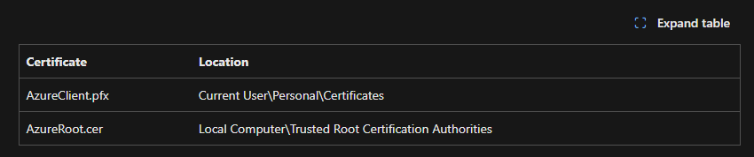

    I understand you are getting Error 798. Can you please try the troubleshooting steps mentioned here and see if that resolve the issue.
    • Symptom: When you try to connect to an Azure virtual network by using the VPN client, you receive the following error message:
    A certificate could not be found that can be used with this Extensible Authentication Protocol. (Error 798)
    • Cause
    This problem occurs if the client certificate is missing from Certificates - Current User\Personal\Certificates.
    • Solution
    To resolve this problem, follow these steps:
    Open Certificate Manager: Click Start, type manage computer certificates, and then click manage computer certificates in the search result.
    Make sure that the following certificates are in the correct location:
    enter image description here
    Go to C:\Users<UserName>\AppData\Roaming\Microsoft\Network\Connections\Cm<GUID>, manually install the certificate (*.cer file) on the user and computer's store.
