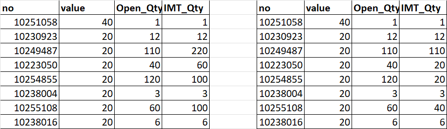

Hi team how to update the values from the below columns
condition is IMT_qty is less than the open_qty field i need to divide the differences between these two columns and update the IMT_qty column, if both the IMT_qty&open_qty are same will keep the same IMT_Qty value in the IMT_Qty column.
case when IMT_Qty < Open_Qty then IMT_Qty/Open_Qty else IMT_Qty end
Attached is the required screenshot for the output.
how to write the correct statement for update

    Your screenshots does not match the description. From the screenshots it looks like you want
    UPDATE tbl
    SET  IMT_Qty = ITM_Qty - Open_Qty
    WHERE IMT_Qty > Open_Qty

    Hi @Naresh y
    Try this:
    UPDATE TableName
    SET IMT_Qty = CASE WHEN ITM_Qty = Open_Qty THEN IMT_Qty ELSE ABS(ITM_Qty - Open_Qty) END
