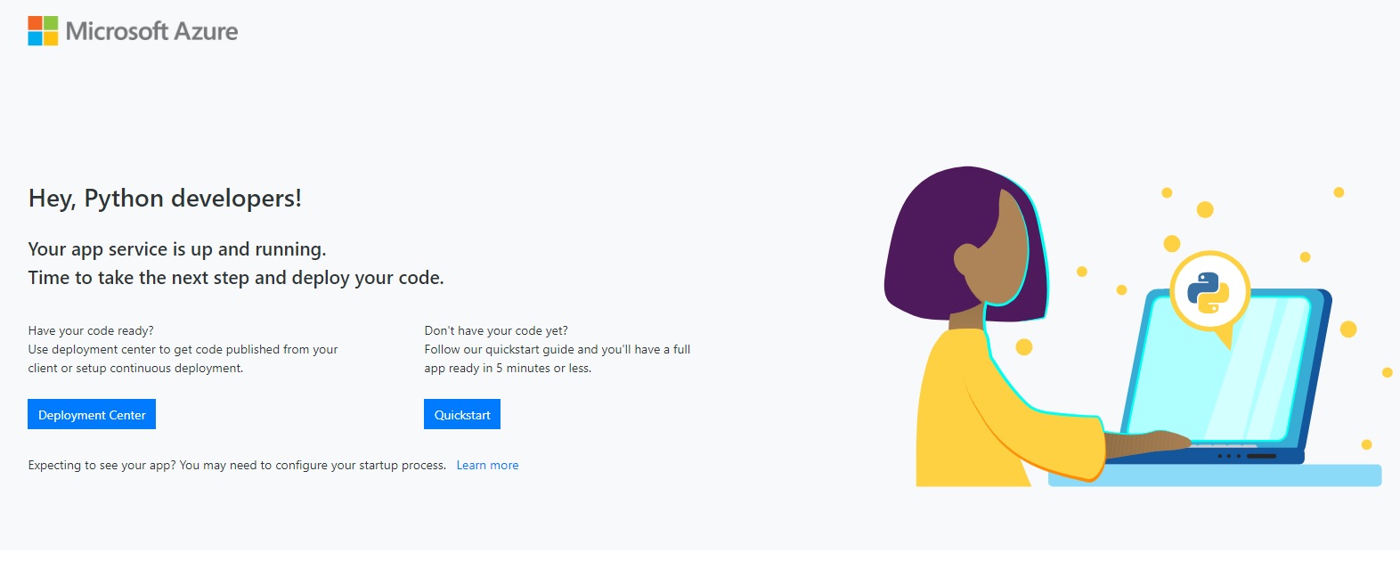

Hello, We have configured GitHub in the Deployment Center for the testing slot, but we cannot access testing and production URLs at the same time. We have another WebApp and that perfectly works fine, but the new one that I've created is not working with both the prod and testing URLs at the same time. So after swapping from production slot to the testing slot, the production URL won't work but the testing URL works, and after swapping from the testing slot to the production slot, the production URL works but the testing URL won't work.
I've configured the environment variables as expected, I've enabled all the Deployment Slot Settings in the configuration tab, but I'm getting the above page as if I've not pushed the code to the server. Please help!!!!

    This sounds to me like expected behaviour. What I mean by that is the way the slot swap works is if you’ve deployed the code to your staging slot and swap this to production, the staging slot will now be whatever was last on that production slot in terms of code. If the last code was just the default app service code then that’s what will be on the swap.
    You need to deploy your code again to the slot so both have matching code. That way, when you deploy changes next time and swap you will have a revert method to the old working state in addition to the zero downtime deployment benefit.
