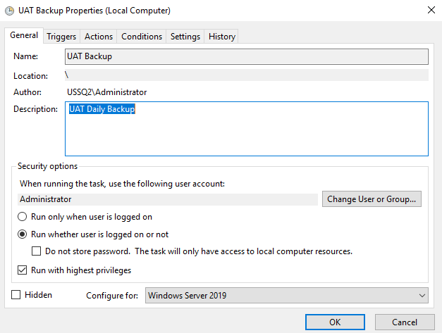

I am trying to run automation using Task Scheduler on my Windows Server 2019 which is my SQL server. I have created a Windows PowerShell script that calls to an external Azure site to grab a file and store it locally. In my script, I need to run a command to execute the task. Unfortunately, when setting up Task Scheduler to have this run automatically, it is failing with the directory name is invalid. User's image
Program/Script - Points to PowerShell - C:\Windows\System32\WindowsPowerShell\v1.0\powershell_ise.exe Add Arguments points to the command you need to run once the script it open Start in points to my .ps1 script User's image
When I run it, I get: Task Scheduler failed to launch action "C:\Windows\System32\WindowsPowerShell\v1.0\powershell_ise.exe" in instance "{97f26cda-8700-4dc2-93ee-f3df8823962f}" of task "\UAT Backup". Additional Data: Error Value: 2147942667.
