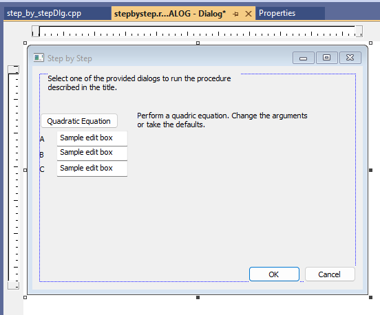

Hopefully, an image of the dialog will be shown somewhere in this question. I tried for the bottom after all the text. Now that its here I don't know how to move it. dialog_1
An initial dialog has been created as shown.  Right click on any of the edit control items, containing the text “Sample edit box” and select properties.  The dialog does not show the properties for the selected edit control.  It shows the properties for the button titled Quadratic Equation.
Oops, while writing this, and going back to VS to get the question exactly right, something has changed.  Now it shows the selected Edit Control.  But I cannot change the name of the edit control.  Earlier I was able to change the name but cannot get back to that situation again.  Still, in the properties dialog, there is no field for the initial text of the control item.
1.       What are the steps to change the initial value of the edit control from “Sample edit box” to, for example, 1.0.

    1. "Sample edit box" is just something displayed by the dialog editor. If you want to populate the control you do so from code. As this is MFC you'd normally do so via DDX - Dialog Data Exchange.
    2. To set the edit control to number only, set the Number property to true.

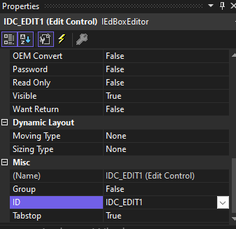

    In addition to using the class wizard to bind controls, you can also use GetDlgItem.
    Right click the edit control -> properties to get its id. such as IDC_EDIT1.
