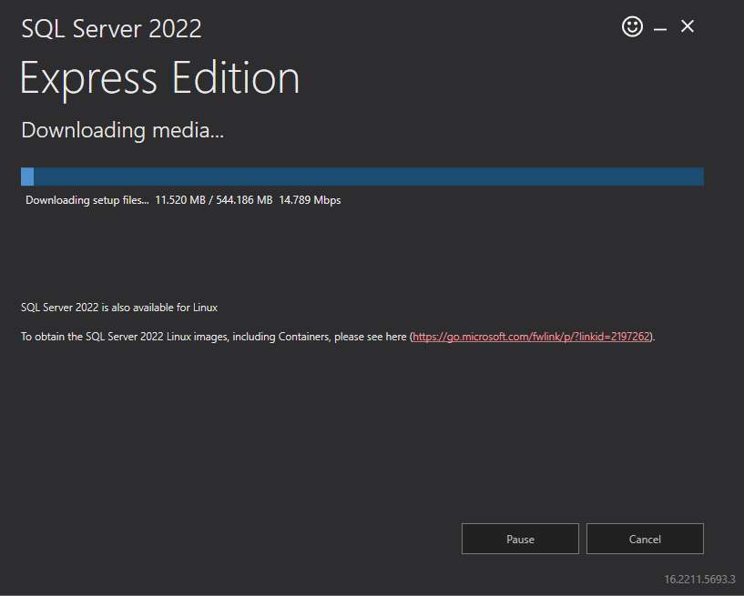

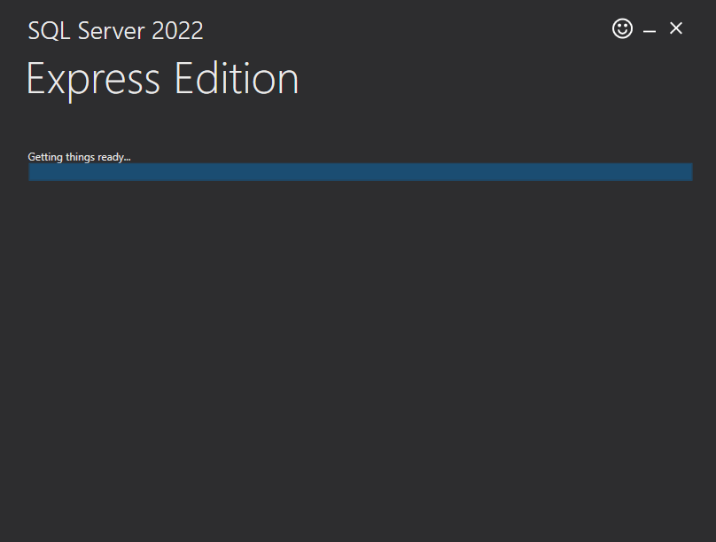

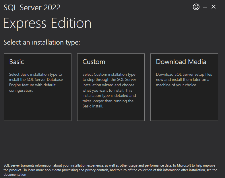

I have downloaded the correct files from this link and trying to install a SQL server Express edtion alongwith SQL server management studio but the installation is getting failed evertime I try to install.
https://learn.microsoft.com/en-us/sql/ssms/download-sql-server-management-studio-ssms?view=sql-server-ver16
SQL Server Management Studio - As soon as I begin the installation, the sytem recognises the click and asks me to run the .exe file and then nothing happens after a few seconds. I have tried this over 20 - 25 times now. I have chcked if any antivirus is trying to stop the program but cannot find the reason why it is constantly being stopped from the background process. I feel that some unwanted program is trying to stop the installation, but I don;t know how to figure that out.

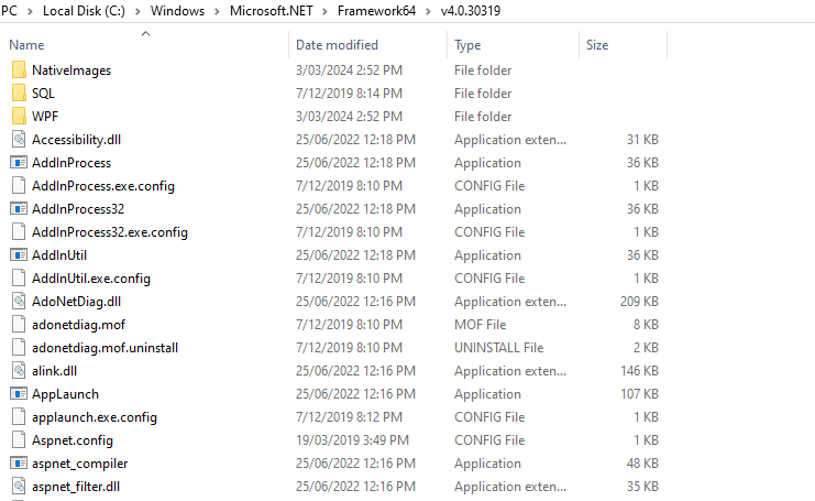

Also, I have installed the most recent .NET framework as well but that did not help either.

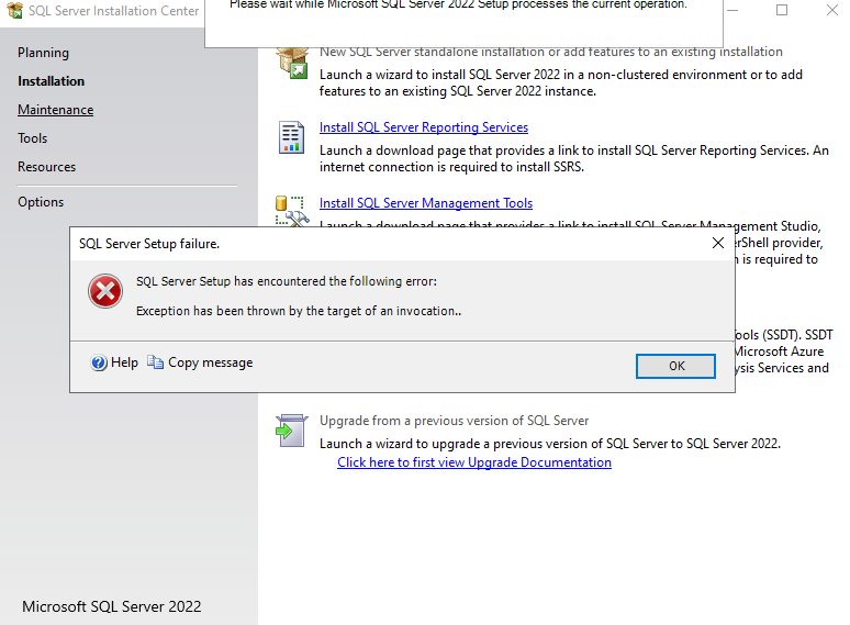

For SQL Server Express setup I am getting this error:
TITLE: SQL Server Setup failure.
SQL Server Setup has encountered the following error:
Exception has been thrown by the target of an invocation..
For help, click: https://go.microsoft.com/fwlink?LinkID=2209051&ProdName=Microsoft%20SQL%20Server&EvtSrc=setup.rll&EvtID=50000&EvtType=0xE8049925%25400x42B4DED7
BUTTONS:
OK
Can someone help me to get it installed on my laptop?

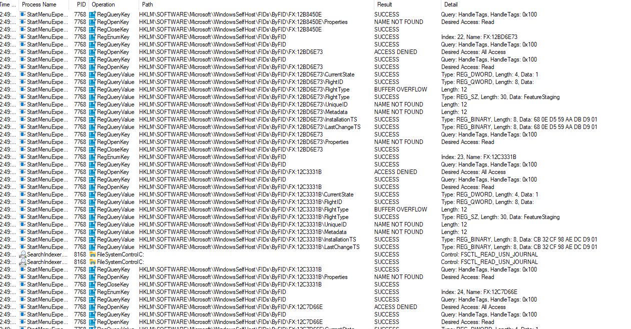

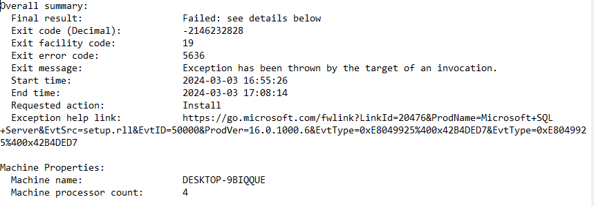

    Hi @Mandeep Singh,In the detail log we can see this.
    Unable to open hklm registry key SOFTWARE\Microsoft\MSSQLServer, error The system cannot find the file specified.
    If you use installationpath C:\SQL2022\Express_ENU\x64\setup, system may not find key.
    Please try with default path like C:\Program Files\Microsoft SQL Server.
    If this does not work, try to first clear uninstall the SQL Server and then install it.
    Use process monitor to get more trace with setup.exe&senarioengine.exe.

    Hi @ZoeHui-MSFT I have changed the installation path as well (C:\Program Files\Microsoft SQL Server) but it's still showing me the same error. Sending a screeenshot of the problem below, does this indicate something in particular that can rectify this?
    Process Monitor log file
