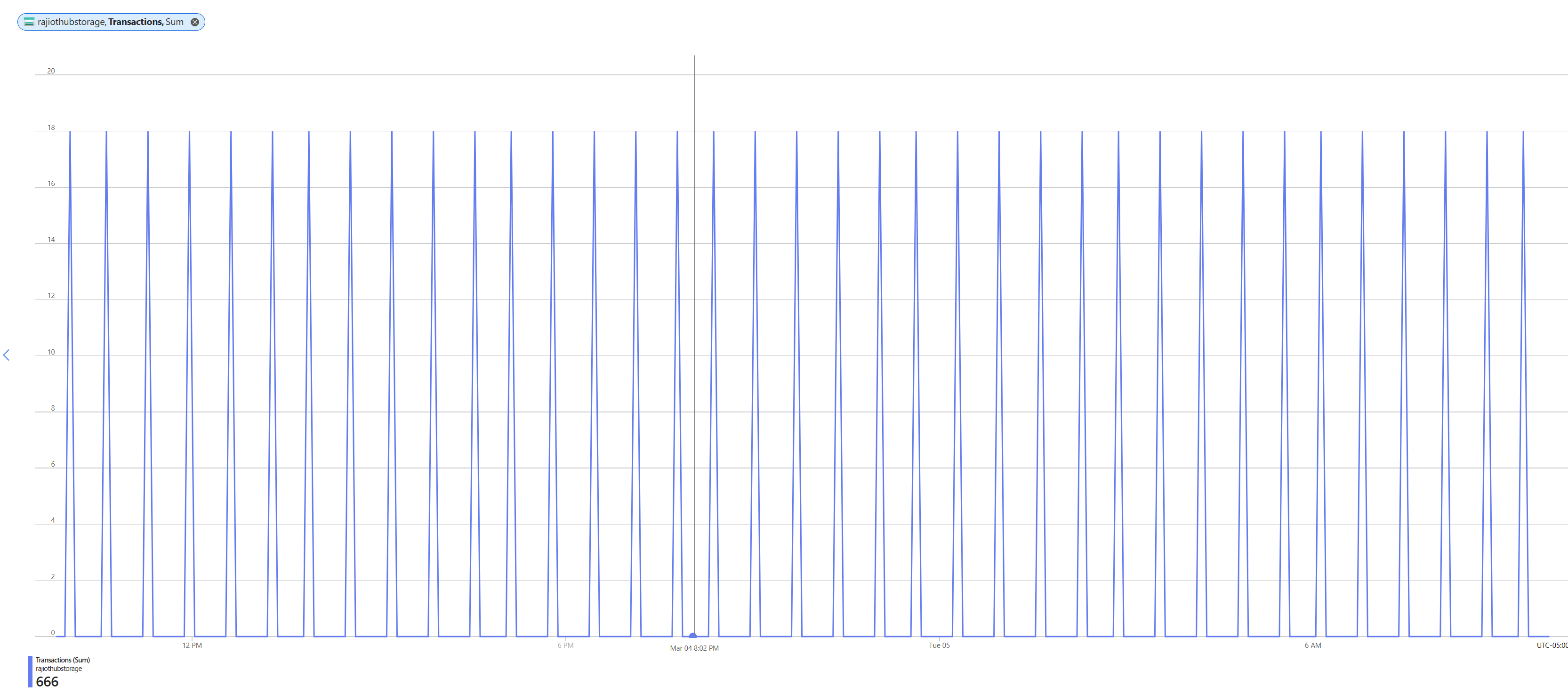

    There is no out of the box view provided on IoT Hub to monitor/track the file uploads. If you files are being routed to a same blob storage end point, you can create a view on the storage container and keep track on the total transactions on the end point such as below.
