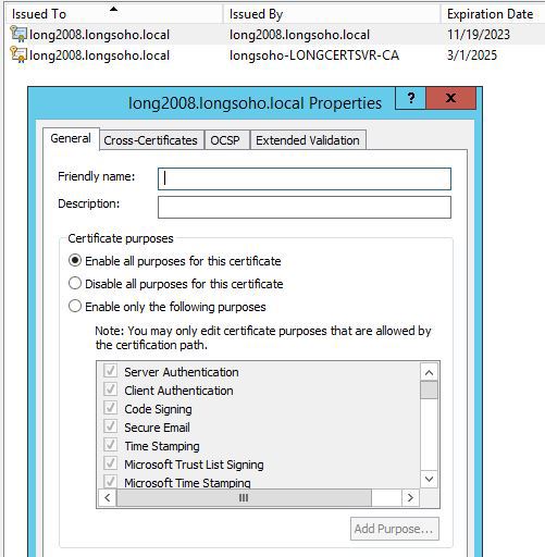

The server certificate is expired and corrupted. IP address of server is.4
Server Certificate_IP address
Symantec Managment console will not open for me to update user licenses.
Certificate MMC:
Certificate Authority console
What are my options? Can I disable local and use the certificate from my certificate server? or what else can I do to clear this.
The certificate server (LongCertSVR) was offline for some time (restored hacked system; I did not replace certificate server). LongCertSVR is now operational. Old logs on long2008 showed DCOM issue not finding LongCertSVR. That is now fixed.

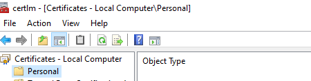

    If so, you can try to add/import the certificate long2008.longsoho.local issued by longsoho-LONGCERTSVR-CA into personal store.

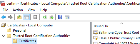

    And add/import the certificate longsoho-LONGCERTSVR-CA into Trusted Root Certification Authorities store.
