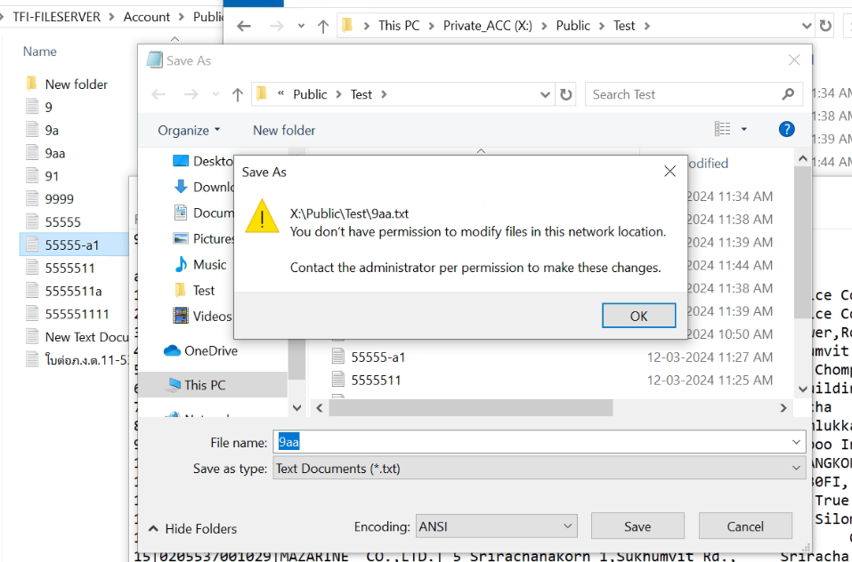

Saving any file to network share folder brings up an error message:
Fileshare\test1.xlsx
"You don’t have permission to save in this location.
Contact the administrator to obtain permission."
Facts:
Saving any file to the local PC is fine
A file with the correct name and extension is created but it is 0kb. If you save the exact same
       file again and try to overwrite the 0kb file then the document s![Screenshot 2024-03-05 120712](/api/attachments/d9c67ffd-799f-4057-8a8f-9646565979c1?platform=QnA)
aved correctly the second time .
When I tried to use 'Simple Tools' such as notepad also have the same symptoms
      (only able to create 0kb file initially, and then when you save a second time it saves correctly).

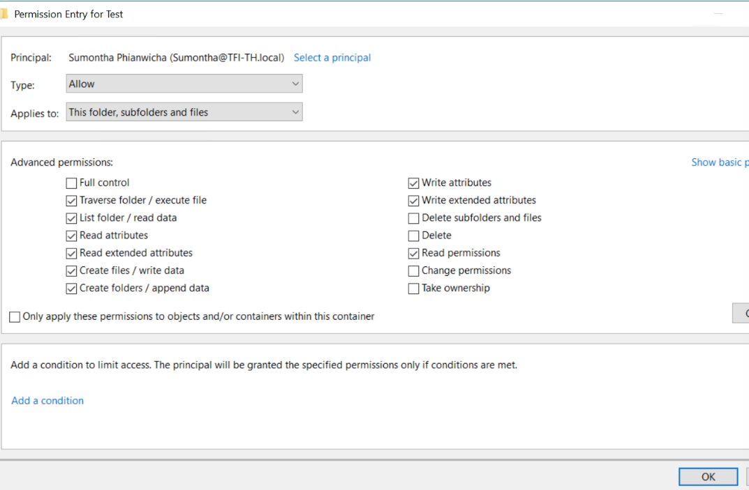

    Hello,
    Thank you for posting in Q&A forum.
    To further resolve this issue, please kindly follow below steps:
    1. Go to the file share folder and right-click the property.
    2. Go to Sharing and check if current user is assigned with this permission.
    3. Go to Security and check if the user has NTFS permission.
    4. Please try with administrator account and see if it works.
    If you don't have admin account, please check with your IT department and make sure the proper permission has been assigned to your account.
    Best Regards,
    Hania Lian
  2. Olaf Helper 47,616 Reputation points
    2024-03-05T06:17:57.88+00:00
    There are 2 different permissions, one on NTFS (file system) level, which seems you have and one on the file share itself; and it seems that one is "read-only".
