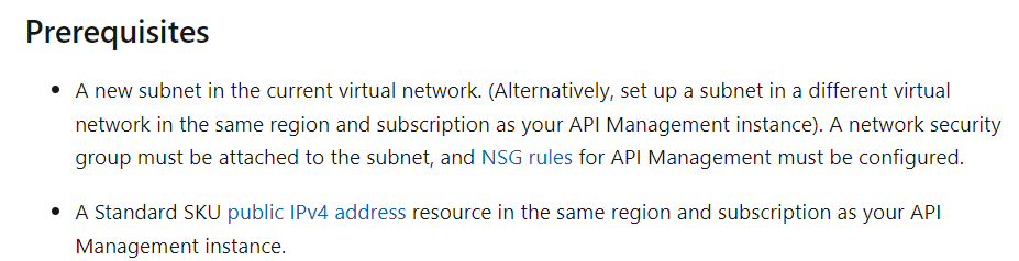

  1. By using old subnet we can migrate the process? or definitely need to change the new subnet?

    Hello @Pardeep the answer to your questions can be found in this Azure doc: Migrate an API Management instance hosted on the stv1 platform to stv2
    Here are some points to bring some clarification to your questions:
    1. To answer your first question, yes migration with the existing subnet (Internal VNet) is possible. You can migrate your API Management instance from Stv1 to Stv2 while keeping the same internal VNet subnet. This option is available through both the Azure portal and Infrastructure as Code (IaC).
