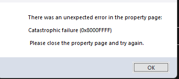

Hi, I m facing some issues:
i was working on patching on themes and icons and then suddenly i ran into a problem, after i patched, i restarted my pc and then the problems happen
none of control panel settings r opening neither is the control panel.
i tried to restore but when i open the restore menu i get this:
User's image i also tried to clean boot and restore but same problem
i cant open file explorer also so i cant access files
Please help me out as this is urgent.
Thanks.
  1. Kapil Arya 8,456 Reputation points MVP Volunteer Moderator
    2024-03-06T17:35:50.0333333+00:00
    Hello,
    Suggest you to run System File Checker scan:
    1. Search for 'command prompt' using Cortana or Windows Search.
    2. From results, right click on Command Prompt and select Run as administrator.
    3. Type sfc /scannow command and press Enter key.
    4. Let the command complete and then reboot the machine.
    If issue still persists, perform clean boot:
    https://support.microsoft.com/en-in/help/929135/how-to-perform-a-clean-boot-in-windows
    Let us know if this helps!
    2024-03-08T02:36:10.46+00:00
    Hello,
    Here are some steps you can take to troubleshoot and check issue:
    1. Open Command Prompt as an administrator.
    Type the following command and press Enter: DISM /Online /Cleanup-Image /RestoreHealth
    This will check for and fix issues with the Windows image.
    Clear the System Restore Cache:
    Type chkdsk /f /r and press Enter. You might need to restart your computer for the scan to run.
    1. Restart your computer and boot into Safe Mode.
    Attempt to run System Restore from Safe Mode to see if the issue persists.
    1. Use Windows Recovery Environment:
    If the above methods fail, you can try to perform a System Restore from the Windows Recovery Environment. You can access this by booting from your Windows 11 installation media and selecting “Repair your computer.”
    Best Regards,
    Hania Lian
