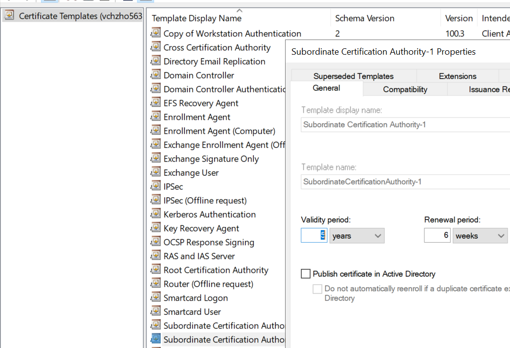

    You can try to look for CApolicy.inf file under C:\Windows and change/decrease the number of the year as below.
    And you also need to check the number of the years on certificate template of Subordinate Certification Authority.
    The number of the year on Subordinate Certification Authority depends on the least value of validity period in Capolicy.inf and in certificate template.
    As we are telling CAPolicy.inf to extend the Root certificate validity to 10 years upon root CA certificate renewal. Existing certificate validity cannot be extended, hence renewal is mandatory so that the extended validity period would be reflected in a new certificate. So if you decrease the validity of the Issuing CA certificate, you should ensure the validity period of existing certificates issued by Issuing CA certificate are not expired after you decrease the validity of the Issuing CA certificate.
