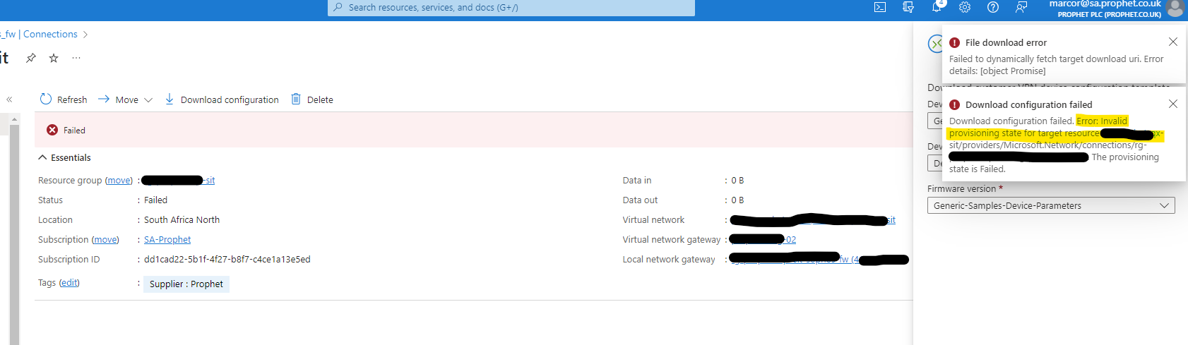

Need assistance in setting up site - Azure VPN connection. On-site we have Sophos XG firewall and I have created virtual network gateway on Azure as well as local Gateway device. Which have been linked in a Connection that I have created in the VNG. My issue is now the following. I need the IP address assigned to the connection once it has been deployed and updated successfully which is downloaded as a general device config file according to sophos community. Unfortunately my connection update fails in Azure, which in turn causes me not be able to download the config file, from where I need to get the ip address that I need to setup in the on-prem fw setup for the site - site connection.

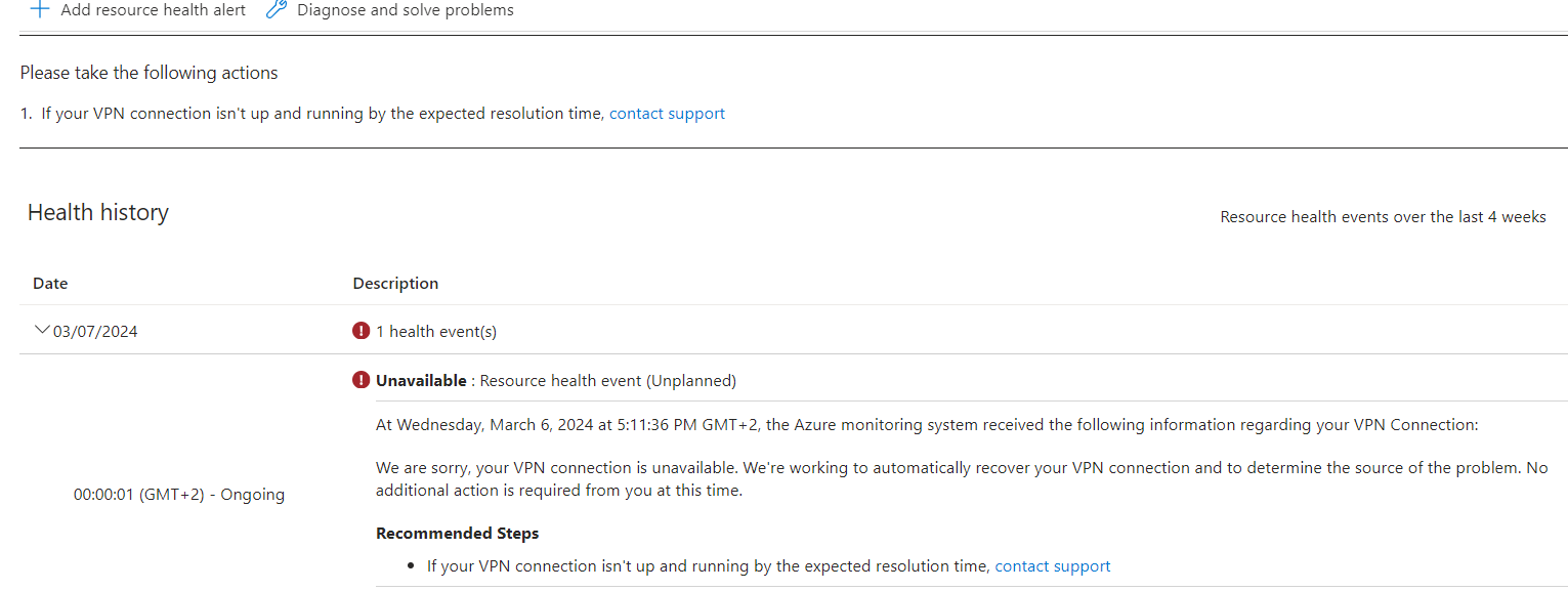

The health status that I am getting indicates the following:
am I missing something somethere, or can someone maybe point me in the correct direction to resolve this. please let me know what other information I can supply

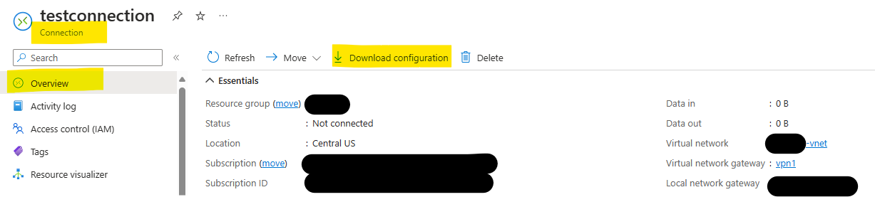

    You can download the configuration script from Azure portal from the Overview page of the Connection (You need to go to the Connection object directly to find the download configuration option):
    https://learn.microsoft.com/en-us/azure/vpn-gateway/vpn-gateway-download-vpndevicescript#download-the-configuration-script-from-azure-portal

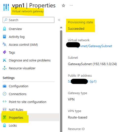

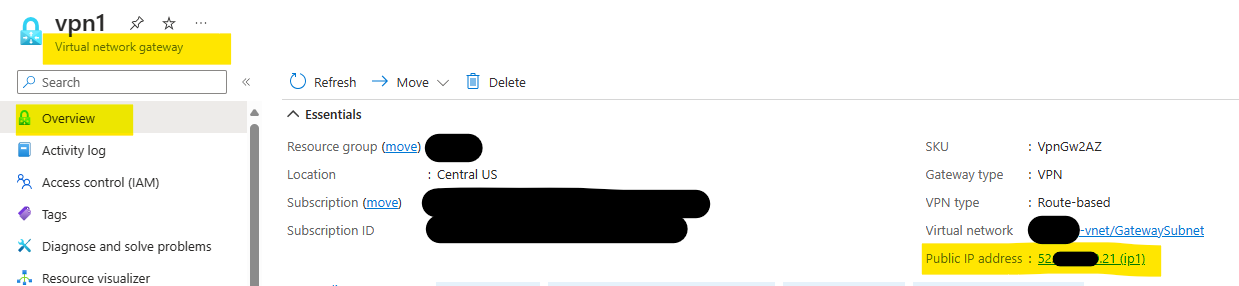

    And to answer your question "from where I need to get the ip address that I need to setup in the on-prem fw setup for the site - site connection":
    You need to get the IP address of the Azure VPN gateway to add that in the on-premises firewall.
