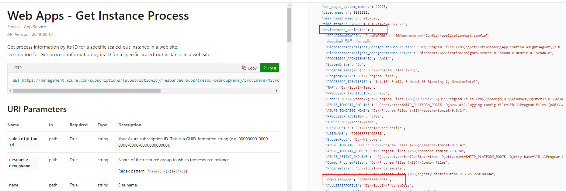

    @Devi Dayal Gupta Thanks for reaching here!
    To obtain the web instance name, you can retrieve it from the instance process using the following method: Web Apps - Get Instance Process.
    And under the environment_variables there is a COMPUTERNAME suppose this is what you want.
    enter image description here
    You can also see computer name under environmental variable- through Kudu-
    Please let us know if further query.
