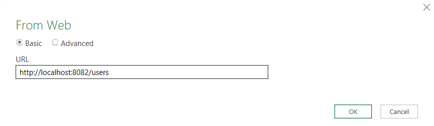

In Excel (Version 2401 Build 16.0.17231.20236), under the Tab "Data", click "From Web" and input a web URL (which is working in browser) and click OK:
Screenshot_from_web

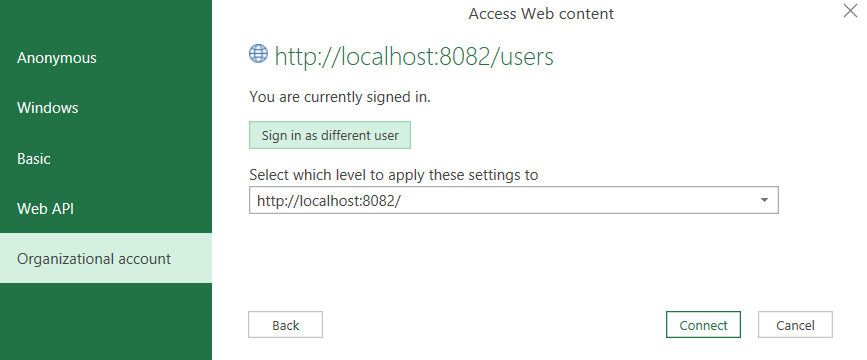

Then there is a pop up window "Access Web content", where a few options are available for signing into the web application. I choose "Organizational account" and click the "Sign in" button, I get the message "You're currently signed in":
Then I click the "connect" button, I get an error message "We couldn't authenticate with the credentials provided. Please try again":User's image

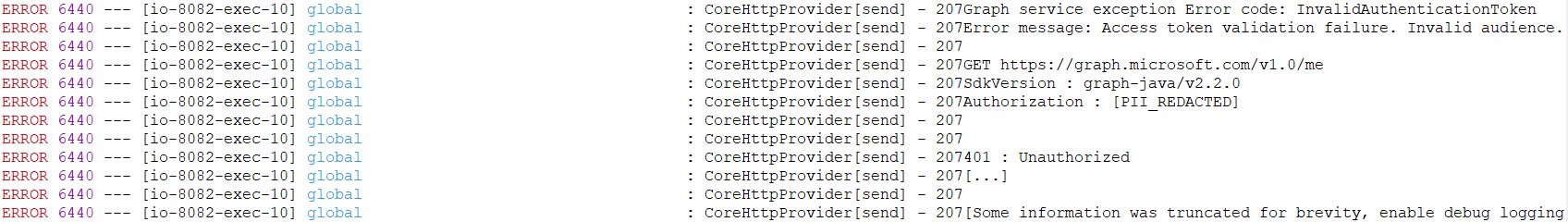

I checked the log file in the server and found the following error messages:
Graph service exception Error code: InvalidAuthenticationToken
Error message: Access token validation failure. Invalid audience.

    The issue was caused by using MS Graph to verify the access token getting from the authorization_uri. It is solved now. Thanks anyway.

    Did you tried to decode the access token using jwt.ms? What are the values you are getting there in scope and audience?
    It seems scopes you are passing is not correct. It should be Application ID URI along with scope name. As per screenshot you have passed localhost URL in place of Application ID URI which is not able to identify your API.
