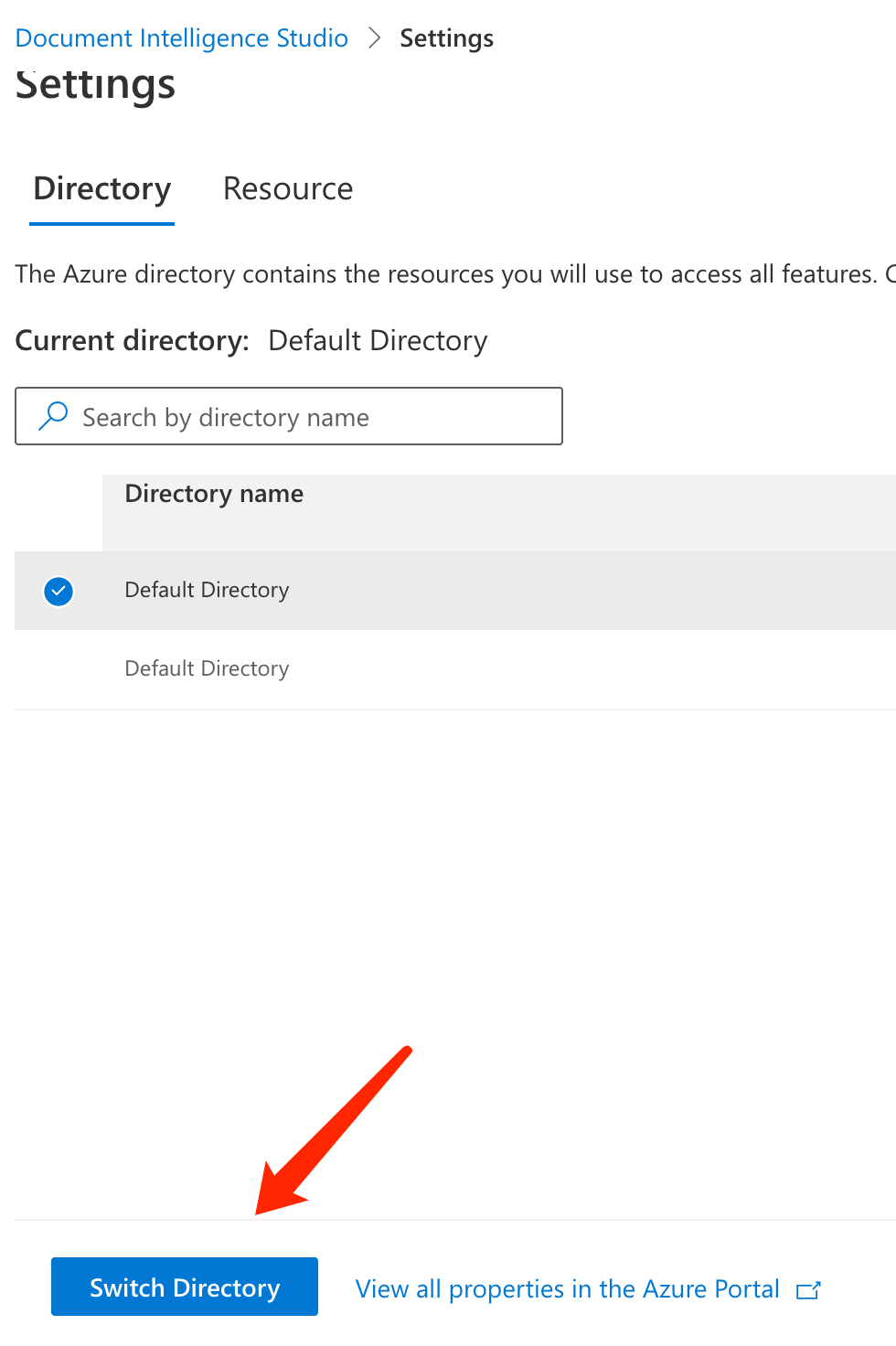

    Please verify that you login to :
    https://documentintelligence.ai.azure.com
    On the upper right gearbox select settings and verify that you have the Directory Selected and the correct subscription
    Try to clear cache and browser data , or try from private window
    Kindly let us know
    I hope this helps!

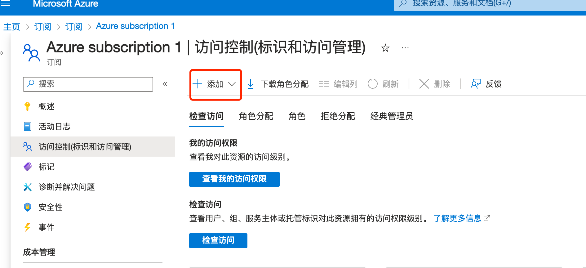

  3. zxtd 30 Reputation points
    2024-03-09T09:42:33.28+00:00
    After constant trying, I found a way to solve this problem. In the subscription rights management system, add a new access account to the subscription that needs access. Then when using Document Intelligence Studio, log in with the newly assigned account and you can use it.
