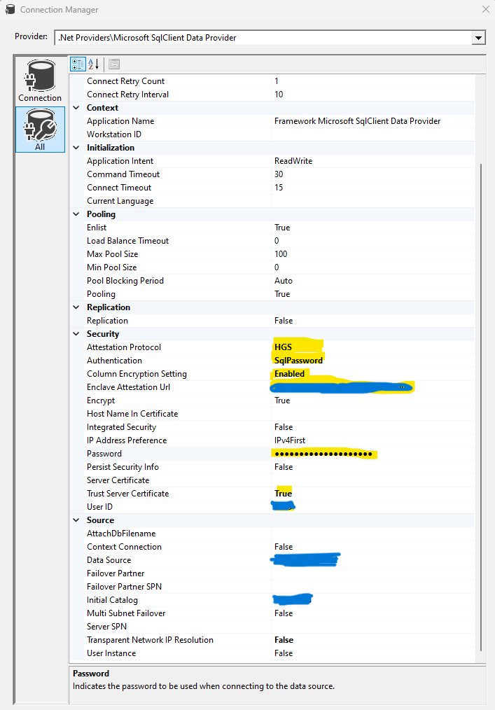

I just upgrade MSSQL and VS to 2022 and I have a data flow where the destination is an Always encrypted table in SQL Server. I switched the cllient provider to the Microsoft SQLClient Data provider, The connection test is successfull, the data preview works however when I try to run the package, I receive this error message "Error: 0xC0208452 at Load DW, ADO NET Destination [2]: ADO NET Destination has failed to acquire the connection {45360D12-CEA8-47A1-8D9B-F27660B235C6} with the following error message: "Could not create a managed connection manager.". What is missing?

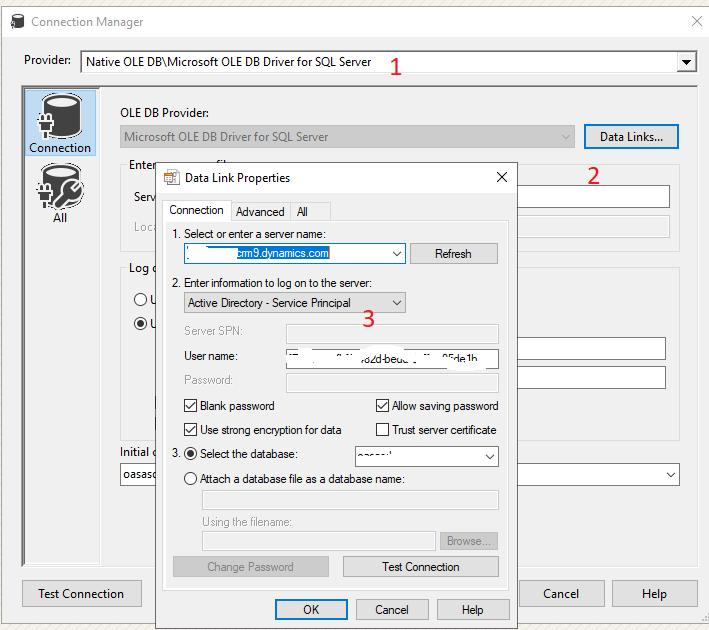

    I was able to resolve the issue by using Microsoft OLE DB Driver for SQL Server option:

    I solved the issue by dropping the ADO destination and create a new one in the data flow, and set the table and mappings again. Also, this is the configuration of the properties I had to set in the connector to make it work with Always Encrypted:
    ADO.NET Microsoft SqlClient Data provider settings redactable The ADO destination for the encrypted table did not work with the .net Provider \ SqlClient Data Provider, only with the Microsoft SqlClient Data Provider.
