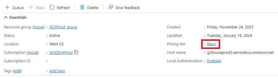

    In the portal, please navigate to your service bus namespace -- Overview blade, then click on Pricing tier Basic under Essentials, as shown below:
    qna service bus change tier1
    On the right-hand flyout window, click Standard, then click Select button.
    qna service bus change tier2
    It should start the update to Standard tier. Usually doesn't take long to complete.
