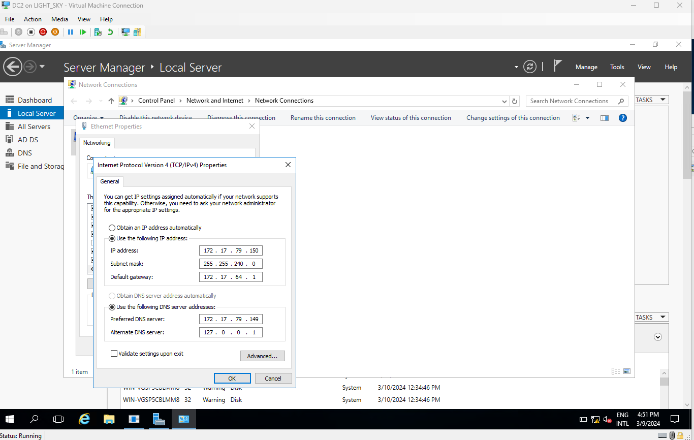

I have deployed 2 windows 2016 servers and installed AD DS services on them. I created domain on DC-1 and assigned a static ip and it worked. I used DC-2 to connect to existing domain and connected it to DC-1. All this setup is done in hyper-v.
However both of my DC's are not getting internet connection. Can you advise what to do next in order to get internet connectivity?
DC-1:DC1
DC-2:
DC-2
Thanks.
