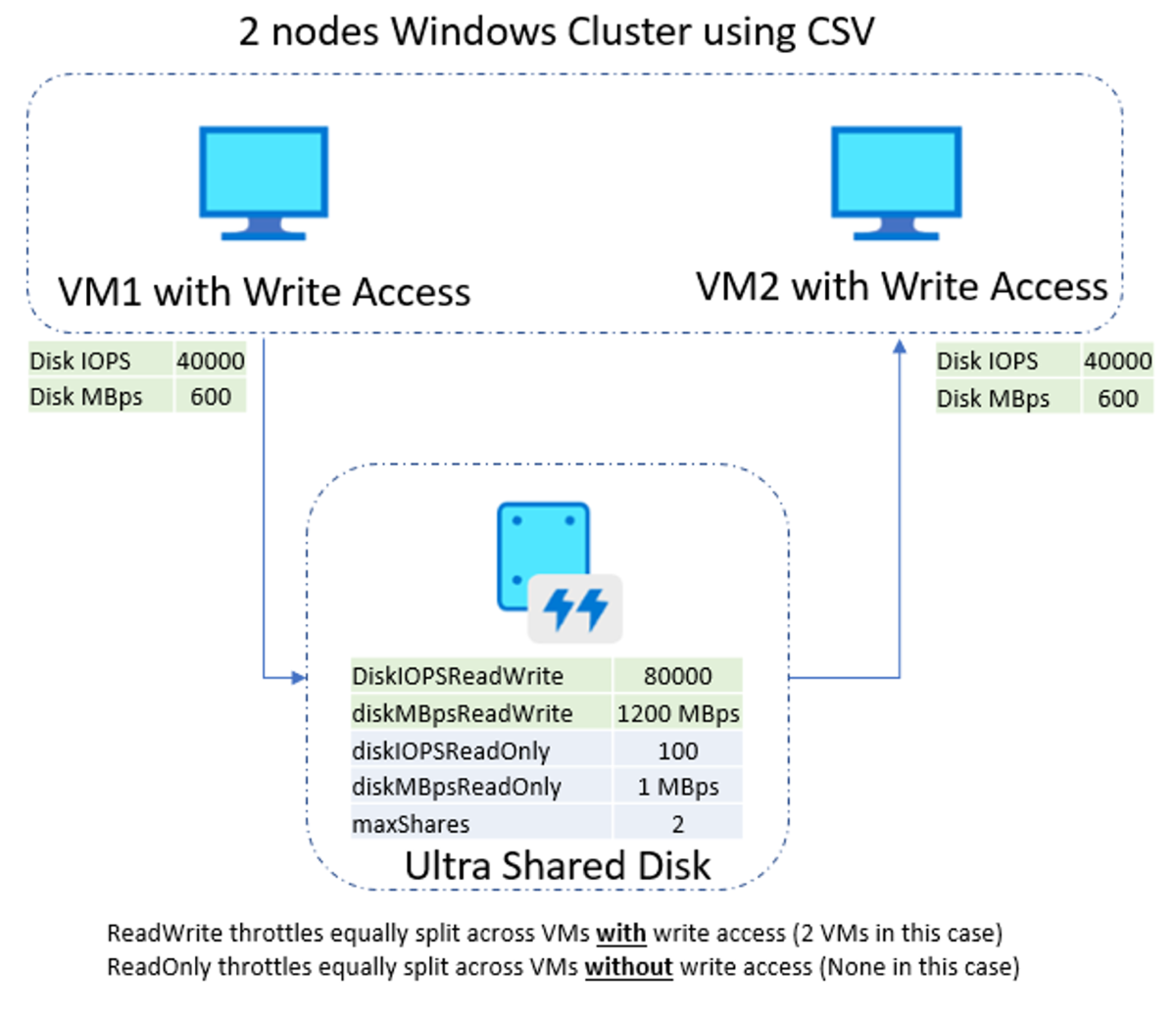

    The following is an example of a 2-node WSFC using clustered shared volumes. With this configuration, both VMs have simultaneous write-access to the disk, which results in the ReadWrite throttle being split across the two VMs and the ReadOnly throttle not being used.
    CSV two node ultra example

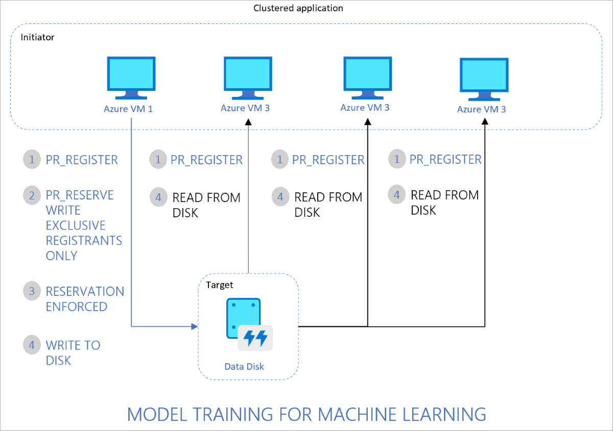

    The following diagram illustrates another common clustered workload consisting of multiple nodes reading data from the disk for running parallel processes, such as training of machine learning models.
    Four node VM cluster, each node registers intent to write, application takes exclusive reservation to properly handle write results
