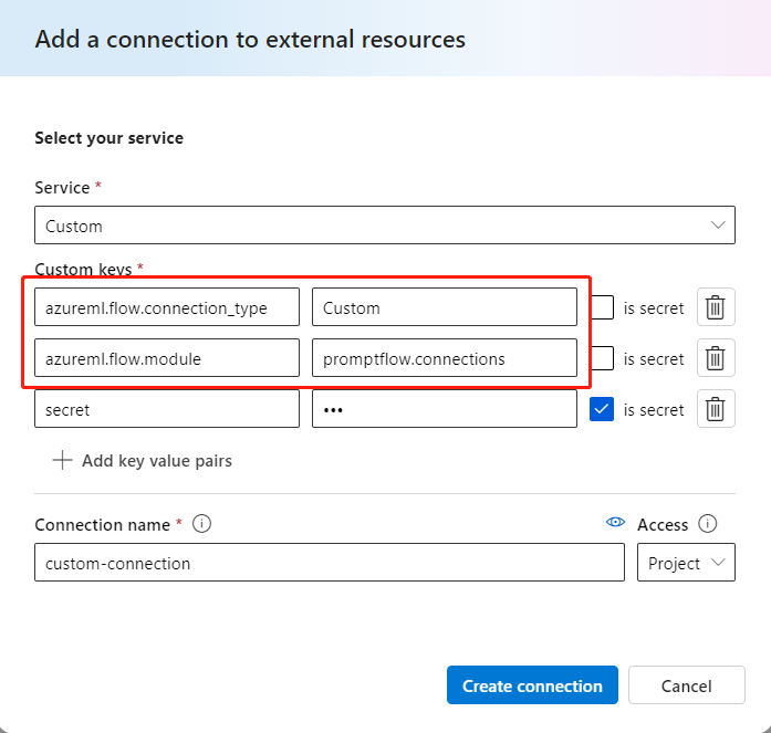

    @Divyansh Singh I would recommend to use custom connection and store the secret of your bing endpoint. I have tried adding the key or secret using these steps.
    Add your bing key or secret in the last key pair and mark it as a secret.
    Screenshot that shows add extra meta to custom connection in AI Studio.
    Before creating the connection select the appropriate Access type. Use Shared instead of Project if the project owner is different.

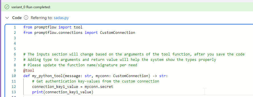

    Once connection is added, add a Python tool in your flow and update the code section to below:

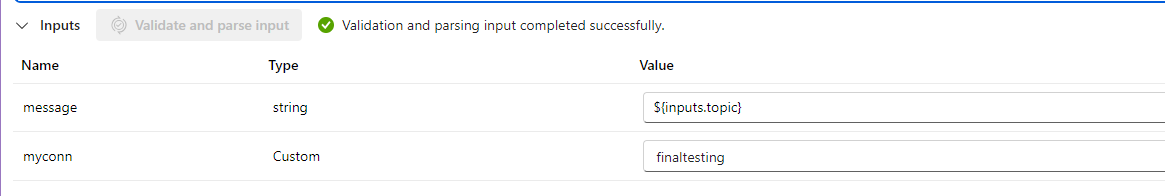

    Hit the Validate and Parse input button and then select the inputs of your python tool.
    I used the name finaltesting.
    Select it and run the tool or flow.
    Here, I printed the key to check if it is correct and it should be available in your logs.
