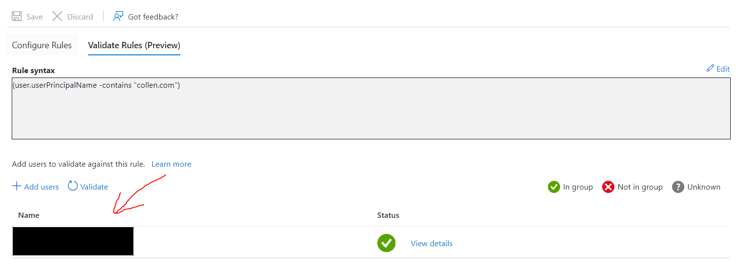

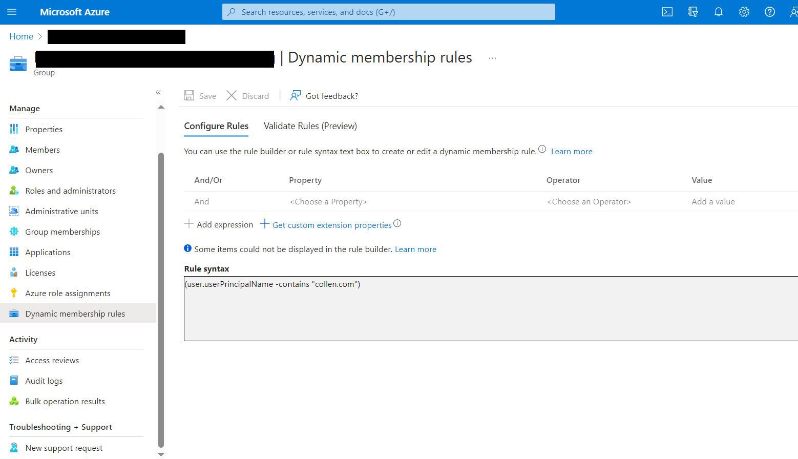

Hi All,
I have set a dynamic group for meta compliance enterprise app and have many users in the group, i am unable to remove user from the group. I log in as global admin, Add member and Remove member is greyed out.
Also in Dynamic membership rules options are greyed out to add rules or edit rules.
Has anyone faced this issue?

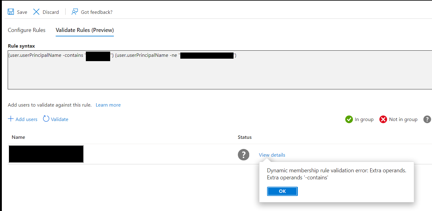

  3. Alex Rabbi 66 Reputation points
    2024-03-19T19:34:00.7533333+00:00
    I tried exactly what you provided with user details
    When i click on view details, i get this

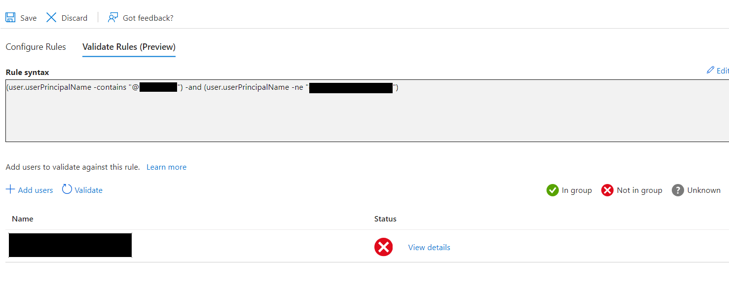

  4. Alex Rabbi 66 Reputation points
    2024-03-20T12:13:00.8366667+00:00
    Thanks Babafemi,
    this one worked, but it took some time to reflect
    (user.userPrincipalName -contains "test.com") -and (user.userPrincipalName -ne "******@test.com")
    Thanks very much for your help, i have clicked on accepted answer
