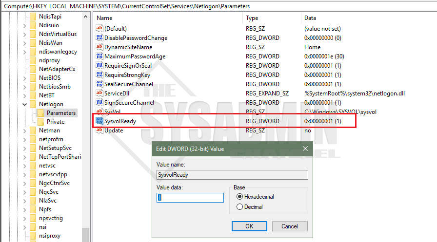

  3. Thameur-BOURBITA 36,261 Reputation points Moderator
    2024-03-23T09:49:58.0466667+00:00
    Hi @Jan Ulman
    I already encountered sysvol and netlogon sharing issues after promoting the new domain controller. I fixed it via this registry key:
    • Login to your Domain Controller that’s having the issue
    • Open Regedit
    • Browse to: HKEY_LOCAL_MACHINE\SYSTEM\CurrentControlSet\Services\Netlogon\Parameters
    • Set SysVolReady from 0 to 1
    • Restart domain controller
    Sysvol Regedit missing sysvol and netlogon shares
    Please don't forget to accept helpful answer
