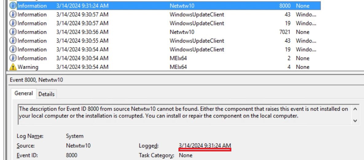

The description for Event ID 8000 from source Netwtw10 cannot be found.
Boopathi S 3,866 Reputation points
2024-03-15T14:13:56.1533333+00:00
Hello,
Please help to understand the below event log message
The description for Event ID 8000 from source Netwtw10 cannot be found. Either the component that raises this event is not installed on your local computer or the installation is corrupted. You can install or repair the component on the local computer.
Same message appears in the System Event ID 7021 7023 7017 7010 7005 7006 7027 7036 7026 7025 8000 7003 6062
What is meant by Netwtw10 and Netwtw14?

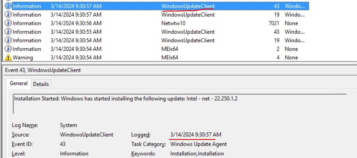

    There are quite a few 8000 event IDs so providing us the full event log information would be helpful. If the event is coming from WLAN-Autoconfig then it is an informational message indicating that a connection to a wireless network was made. In this case the name is either the network adapter name or perhaps the profile name.
    It looks to me, based upon a quick google for the name you gave, that this is related to the Intel network driver as discussed here.
