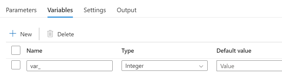

I've implemented a pipeline having a Lookup activity to read a Synapse table to get the parameters to pass a stored procedure inside the next ForEach activity.
Inside the ForEach activity I've use some Set variable activities to get the parameter values for the procedure (using item().myparam).
Now, could I execute the ForEach activity in parallel mode successfully without a variable was set with the value referred to another iteration item?

  1. AnnuKumari-MSFT 34,566 Reputation points Microsoft Employee Moderator
    2024-03-20T09:46:50.63+00:00
    Hi pmscorca ,
    I understand your query is if we can execute a ForEach activity in parallel mode without a variable being set with the value referred to another iteration item. Please let me know if that is not your ask.
    Variables are scoped at the pipeline level. This means that they're not thread safe and can cause unexpected and undesired behavior if they're accessed from within a parallel iteration activity such as a ForEach loop, especially when the value is also being modified within that foreach activity.
    Try using sequential option if you are using variables. However, parameters are much more safe for parallel execution .
