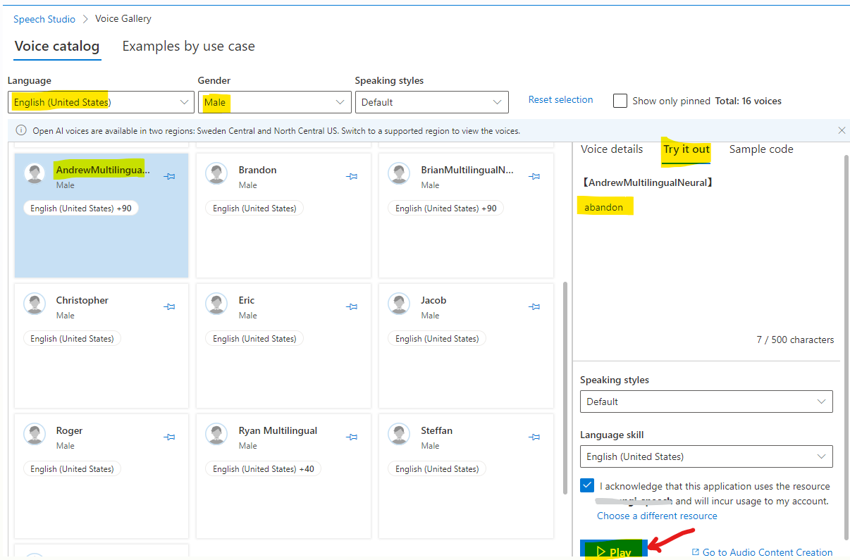

@洋 焦 Apologies for the delay. I appreciate your patience on this.I had reached out to the Product Owners. We confirmed this issue on AndrewMultilingualNeural
voice and we're investigating why it happens. **Plan:**Currently there is no ETA on when the fix would be provided.
I will keep you posted and update this thread once we have a concrete solution for this.
Workaround:
Meanwhile, there's a workaround solution to mitigate it which is adding a period mark(".") at the end of the single word. By doing so, the reading will be correct.**
