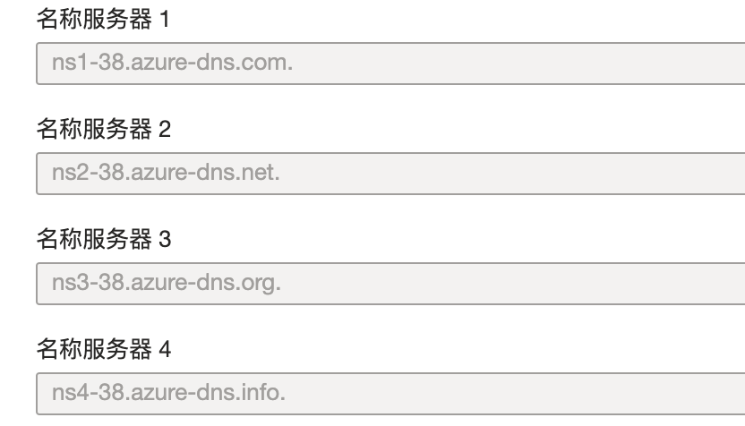

I registered a domain name on Azure, but I want to use cloudflare to host it. However, Azure currently cannot modify the default four name servers, so I cannot replace CloudFlare's name servers. Is there any solution?

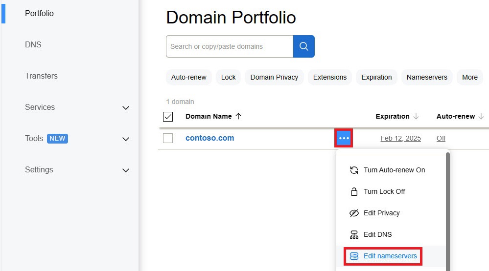

    qna dcc domain list edit nameservers
    Click on the context menu (three dots), then click Edit nameservers.

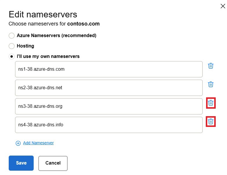

    On Edit nameservers screen, click the trash can icon to delete unnecessary lines as needed:
    qna dcc domain list edit nameservers delete lines

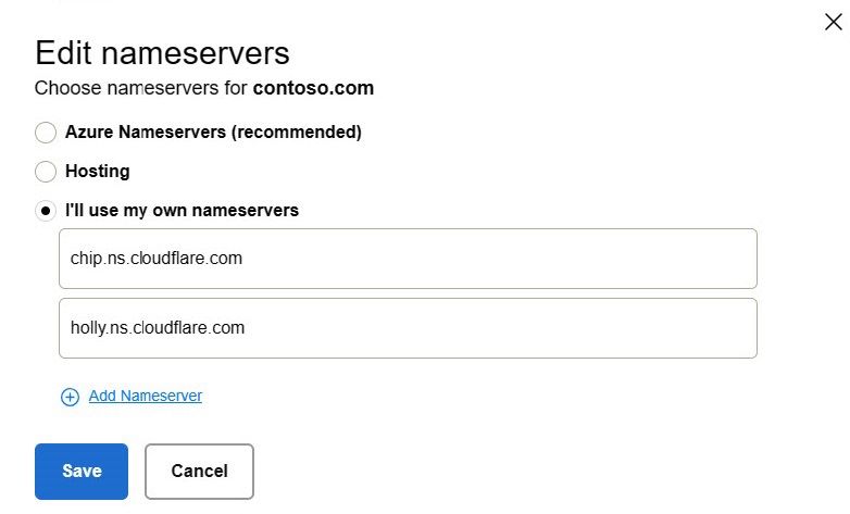

    Next edit the remaining lines and set them to your Cloudflare name servers. You may view the name servers you need to enter on your Cloudflare dashboard -- Websites -- <yourdomain>. When finished it should look similar to below, then click Save.
    qna dcc domain list edit nameservers cloudflare
    There will be a delay for the change to propagate. You may check periodically in Cloudflare to see if it is active.
