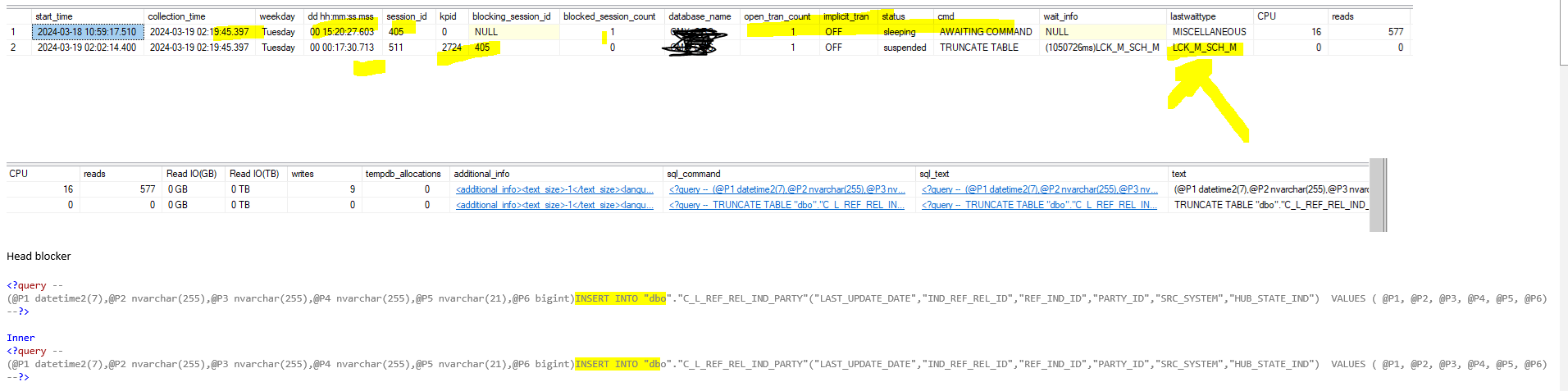

Hi All,
Today came across a blocking issue from the application. A very simple INSERT ran and the spid is in "sleeping" "AWAITING_COMMAND" with an open transaction and lock on the table. After 15 hours, then comes a spid which "truncate that table" and it is waiting on Sch-M lock. There is no implicit_Tran on. but don't know why it has one open transaction. I seeing this behavior quite often and eventually had to kill that insert spid. isolation is Read- committed and RCSI is on for that particular db.
1
<additional_info>
  <text_size>-1</text_size>
  <language>us_english</language>
  <date_format>mdy</date_format>
  <date_first>7</date_first>
  <quoted_identifier>ON</quoted_identifier>
  <arithabort>OFF</arithabort>
  <ansi_null_dflt_on>ON</ansi_null_dflt_on>
  <ansi_defaults>OFF</ansi_defaults>
  <ansi_warnings>ON</ansi_warnings>
  <ansi_padding>ON</ansi_padding>
  <ansi_nulls>ON</ansi_nulls>
  <concat_null_yields_null>ON</concat_null_yields_null>
  <transaction_isolation_level>ReadCommitted</transaction_isolation_level>
  <lock_timeout>-1</lock_timeout>
  <deadlock_priority>0</deadlock_priority>
  <row_count>1</row_count>
  <command_type>AWAITING COMMAND</command_type>
  <sql_handle>0x01000b002c203603d0be7be26602000000000000</sql_handle>
  <statement_start_offset>-1</statement_start_offset>
  <statement_end_offset>-1</statement_end_offset>
  <host_process_id>25578</host_process_id>
  <group_id>2</group_id>
  <original_login_name>app_ors</original_login_name>
</additional_info>

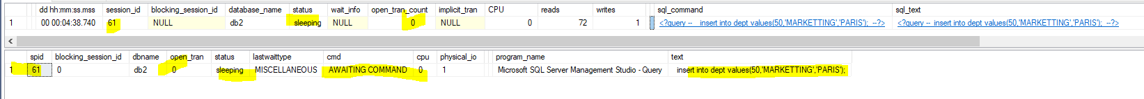

My questions, by default any connection to sql server will be auto-commit mode , (correct me if I am wrong). I have tested this with a small insert on dept table and as and when the insert is done, its auto-commited by default and there is no open_tran. however, it is "sleeping" and "awaiting_command" as expected. I opened a new ssms window and tried to SELECT * FROM DEPT; I was able to see the new record which means the insert has been auto committed.
2
In case, of the application WHY it is keeping the transaction open in that spid for a simple insert.
Am I missing anything? what else can we collect or check to know the root cause of that open txn? is there a possibility of another spid has open that txn( i dont think so) !! . please give some ideas.

  1. Olaf Helper 47,581 Reputation points
    2024-03-19T12:00:54.42+00:00
    I guess the application starts an explicit transaction, and as long as it don't commit, it's quite normal to see the process in SLEEPING state with an open transaction.
