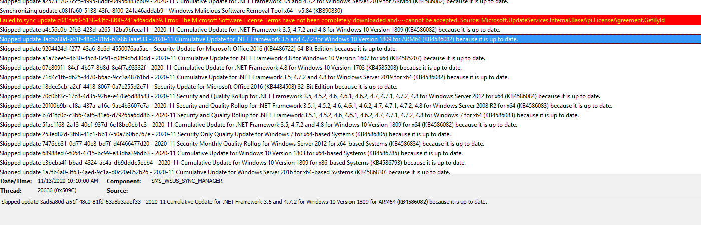

I am planning on upgrading SCCM from 1906 to 2006 and noticed the Software Update Point Synchronization Status failed
When I checked the wsyncmgr log I see this error :
I have manually approved the update on WSUS, error still shows , I am wary about reseting the WSUS so as not to break it. any suggestions ?

    Based on the screenshot, there is one update that have an issue, what is the result (last line) after forcing the software updates synchronization ? Can you share with us the wsyncmgr.log & WMC.log files ?

  2. Amandayou-MSFT 11,156 Reputation points
    2020-11-16T08:55:07.427+00:00
    Hi @sovrano ,
    the error of the microsoft software licence terms have not been completely download and cannot be accepted
    Could we try to re-run the WSUS Server Configuration Wizard on the WSUS console, and re-sync the update to check if the issue could be solved?

    Error = The underlying connection was closed: An unexpected error occurred on a send
    I am getting this error from WSUS_SYNC_Manager logs
