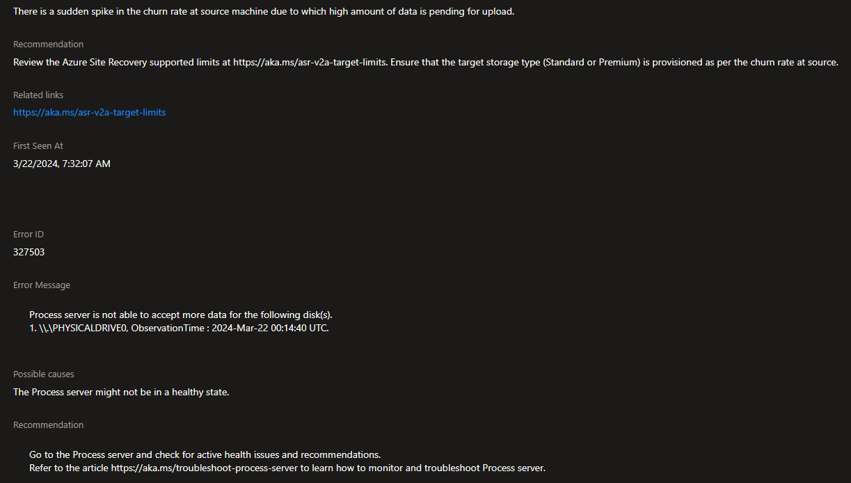

Today i add one VMware guest to be replicated to azure using ASR and found the replication is error with message:

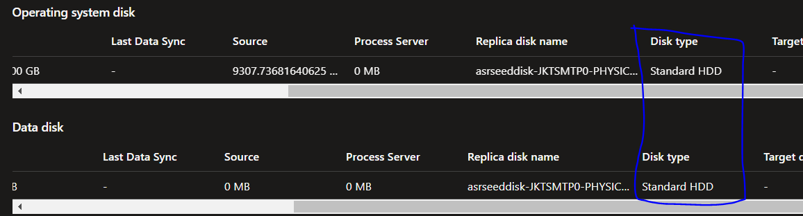

  • The limit can be increased by change the storage type? The storage type mean is HDD model we use for replicating?

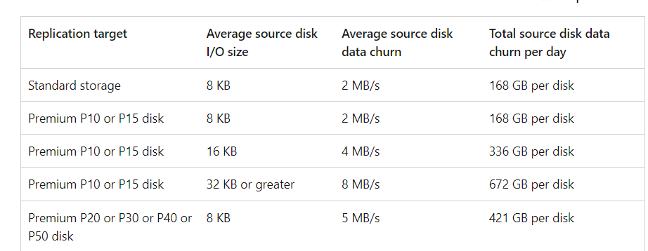

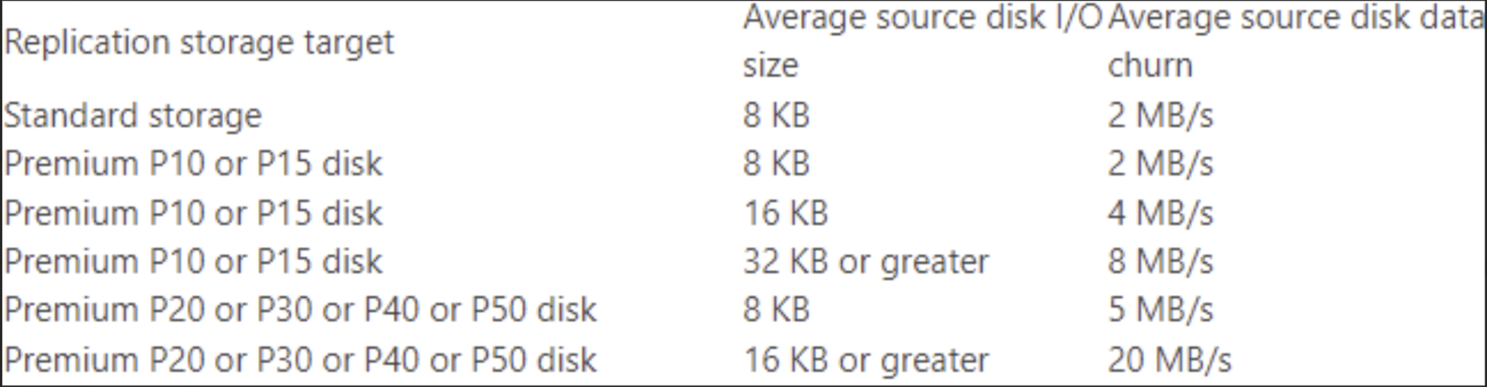

    The Replication status is critical because the disk data change rate on the source virtual machine exceeded supported limits. Azure Site Recovery has limits on data change rate, based on the type of disk. Churn can be expected when VM is offline, unable to reach Azure or has a lot of changed data in a short period of time.
    Based on your disk we have a limit of the amount of data writing speed:
    To fix churn the best approach is to increase the disk tier to a better one that as more capacity.
    https://learn.microsoft.com/en-us/azure/site-recovery/azure-to-azure-troubleshoot-replication#azure-site-recovery-limits
    If the disk or the higher tier disk still cannot resolve the issue, the machine cannot be replicated using Azure Site Recovery. Recommended Documents
