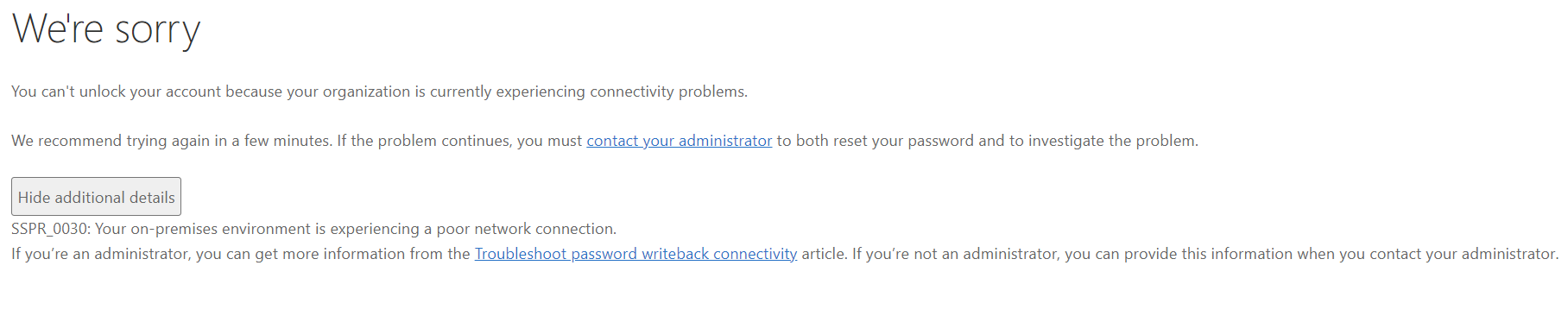

I did a swing migration of AD Connect and export/import from a DC to a doman-joined Windows 2022. However, when I try SSPR I get the following error (image). However, I verified together with an MS Engineer that there are no connectivity issues from the new server. I've disabled and re-enabled writeback, but still no success. However, I see this error when the AD Sync service restarts.
ssprissue
TrackingId: 3c04d636-7c80-4c06-a9b7-380c997692ee, Listener for Namespace: ssprdedicatedsbprodweu, Endpoint: 6b4d1213-177e-4265-8d11-66892fc886c5_c99d45ac-47f4-476c-b38f-ed151dd3b1e5 offline Event. Last error encountered System.ServiceModel.CommunicationException: The connection to the connect service was lost. ---> Microsoft.ServiceBus.ConnectionLostException: The connection to the connect service was lost.
--- End of inner exception stack trace ---, Details: Version: 5.0.922.0
Any additional insights from the community will be appreciated.

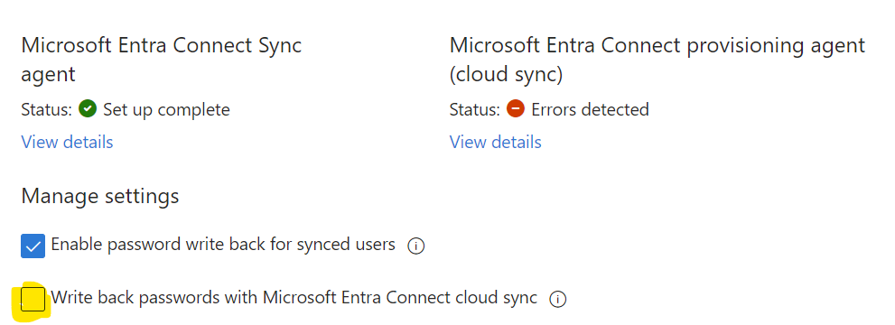

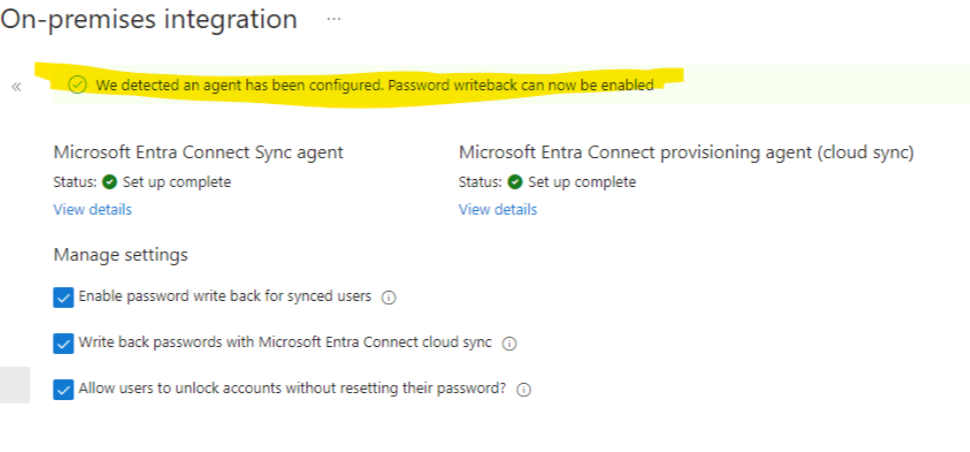

  1. ISE 10 Reputation points
    2024-03-22T11:16:12.7233333+00:00
    I was able to resolve the issue. This is just super weird. On the only DC I had installed the cloud provisioning agent (cloud sync) and also installed in on the new one. However, I uninstalled from the DC but this error was shown which is expected but it was green for the new server. I then decided to remove the yellow checkbox and guess what started to work...SSPR!
