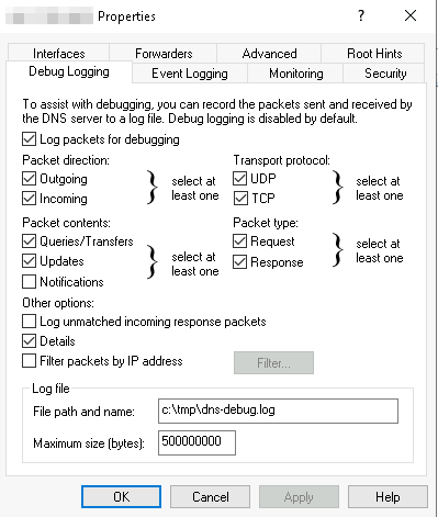

    To troubleshoot DNS resolution issues on your Windows DNS servers, you can enable DNS debug logging to capture more detailed information about the requests and responses. Here's how you can do it:
    1.     Enable DNS debug logging on the Windows DNS server:
    o    Open the DNS Manager on your Windows DNS server.
    o    Right-click on the server name and select "Properties."
    o    Go to the "Debug Logging" tab.
    o    Check the "Log packets for debugging" box.
    o    Select the "Event packets" option under "Debug packet type."
    o    Set the log file path where you want to save the log files.
    o    Click "Apply" and "OK" to save the settings.
    2.     Monitor the DNS debug log files:
    o    Look for log files in the path you specified earlier. These log files will contain detailed information about DNS queries and responses.
    o    Analyze the log files to see the DNS queries and responses, including the IP addresses returned during resolution or timeouts.

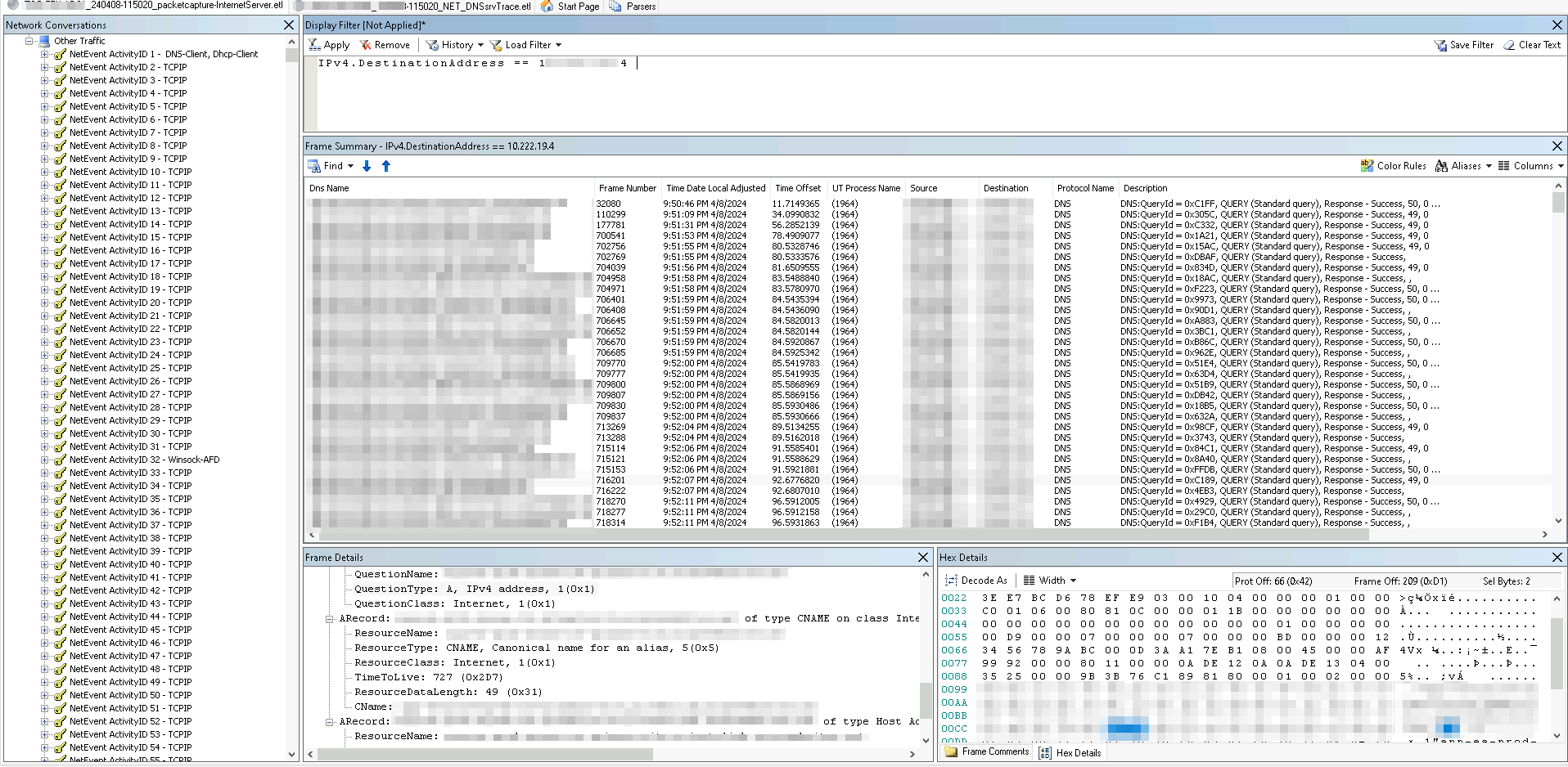

    1. PS C:\TSS> .\TSS.ps1 -Scenario NET_DNSsrv

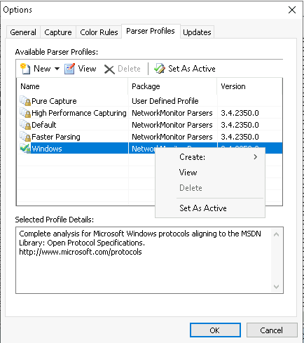

    2. Open file <hostname>__<date>-<time>packetcapture-InternetServer.etl with Microsoft Network Monitor
    3. In Microsoft Network Monitor click on Tools -> Options. Right click on Windows -> Set As Default
    4. Search the IP address in the Display Filter.
