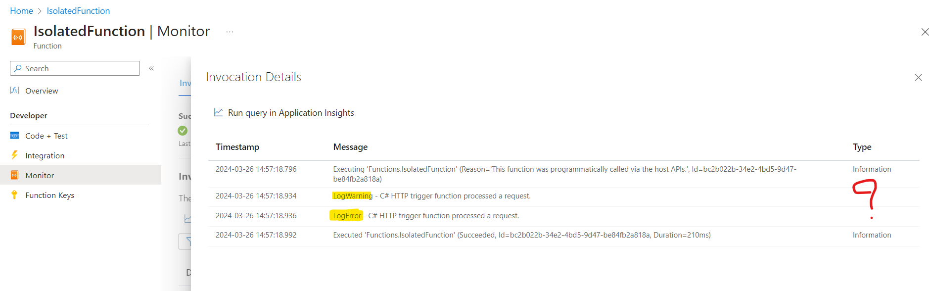

After migrating to Isolated process azure function, information logs stopped to be shown in application insights only Warning and Error logs are stored without even log level.

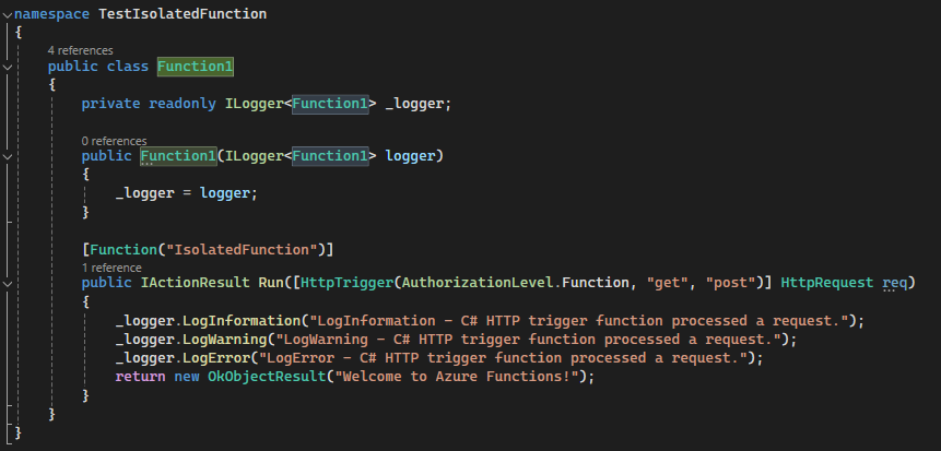

Here is a sample code:
Here logs are shown in console:
But here information logs are not shown and no log level is assigned for warning nor error
