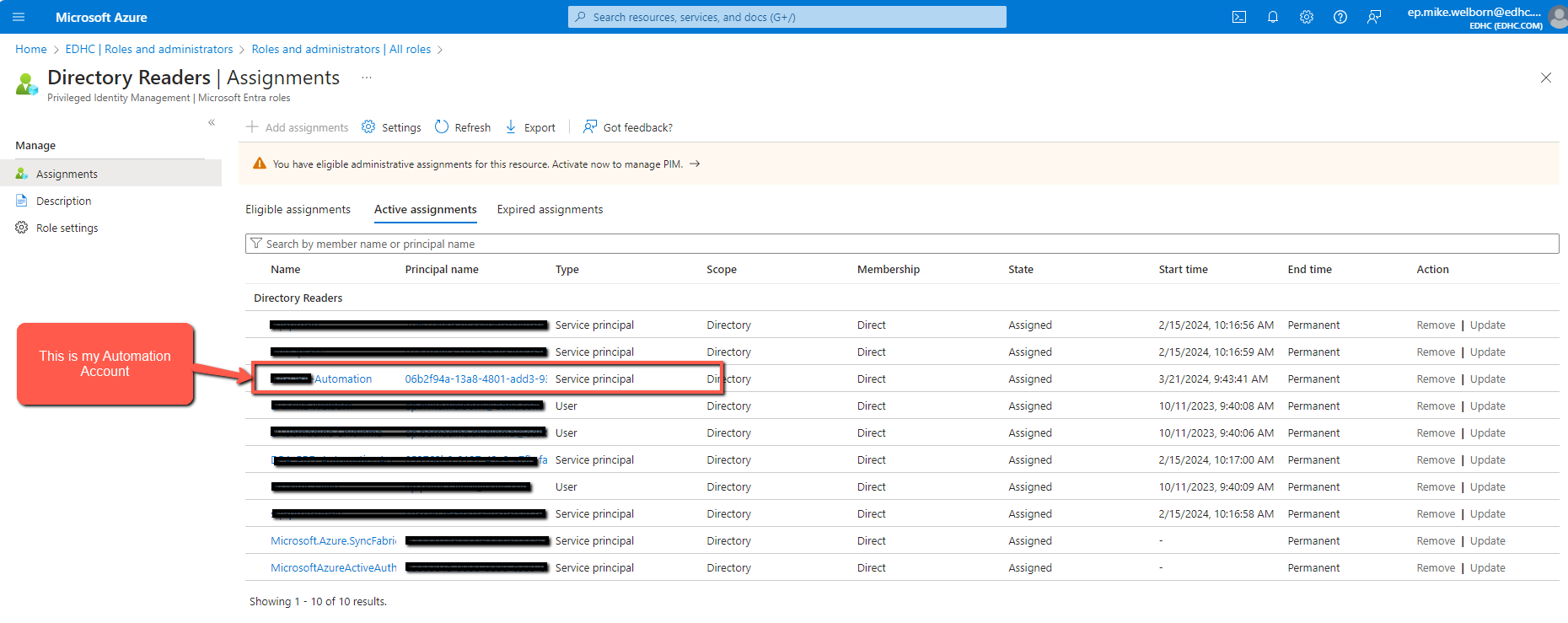

So I thought the issue is permissions related, but my system assigned managed identity has the Directory Reader role in Microsoft Entra.
