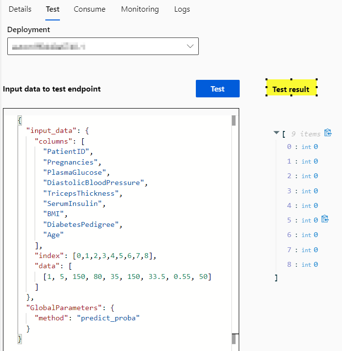

This is the only thing I find on the endpoint tabs to test it, but when I run the test as is I am getting following error directly in the gui
: An unexpected error occurred in scoring script. Check the logs for more info. ID pro sledování : 546ccea3-e3a0-417e-b8a8-37a8e8912191
  "input_data": {}

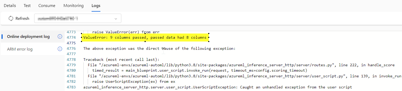

    To resolve the "HttpResponseError" with message "An unexpected error occurred in scoring script. Check the logs for more info." when invoking an online endpoint in Azure ML, I suggest checking the logs for more information about the error, verifying that the input data format matches the format used during training. Verify that the online endpoint is running and deployed correctly.
    If the problem still persists, I suggest you test the online endpoint from the Azure Machine Learning studio portal or POSTMAN tool, to verify if the endpoint is running correctly. Please also check the error logs from the portal, once the endpoint was hit in the portal with the required JSON, parametric values.
    I tried to repro an error randomly by removing one required parameter from my online endpoint JSON and received below error. This repro I have done just to show where to check the logs. Please see below: User's image

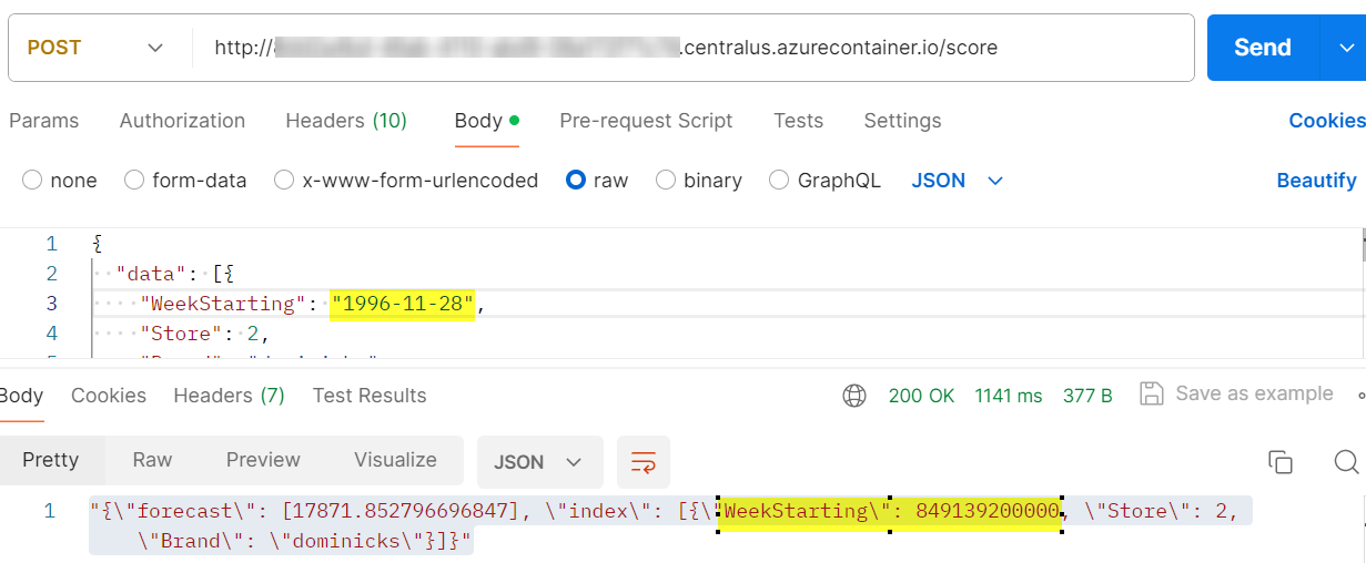

    By passing the required number of parameter values, I was able to successfully get the response from the online endpoint. Please see below User's image
    Please refer to Azure Machine Learning Studio documentation, and try providing a sample input format that matches the format used during training.
