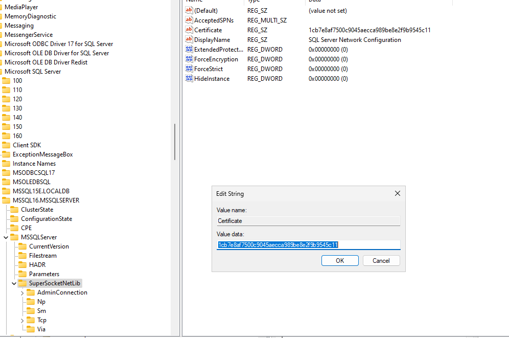

    Configure SQL Server to use a self-signed certificate:
    1.Open the Registry Editor and navigate to the following registry key (the registry path may vary slightly depending on the instance number):
    HKEY_LOCAL_MACHINE\SOFTWARE\Microsoft\Microsoft SQL Server\MSSQL.1\MSSQLServer\SuperSocketNetLib\Certificate
    2.Clear the value of the Certificate.
    3.Open the Microsoft Management Console (MMC) and add the Certificate Management console. Delete all certificates in both the Local Computer certificate store and the Current User certificate store that have a subject field that matches the server hostname (before deleting, you may want to export the certificates as a backup for future use).
    This should allow SQL Server to use a self-generated certificate in most cases.
