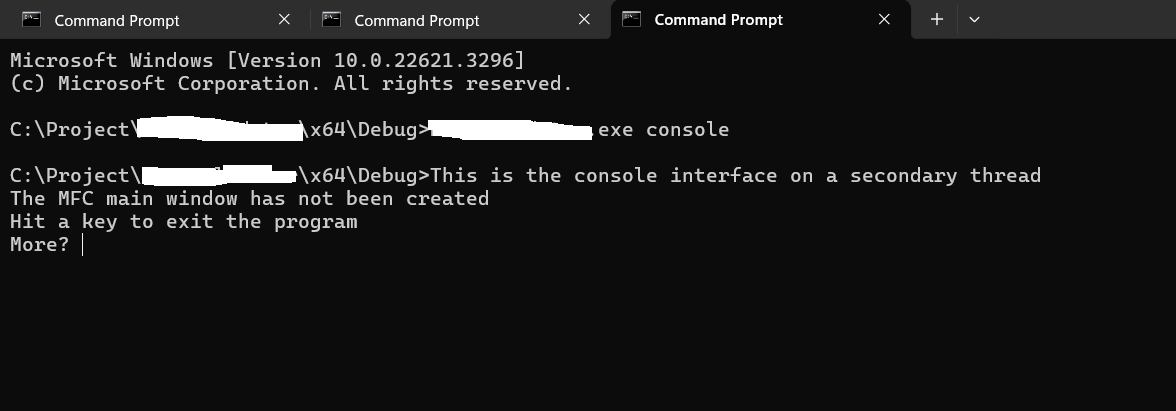

    	if (m_lpCmdLine && *m_lpCmdLine)
    		puts("This is the console interface");
    		puts("The MFC main window has not been created");
    		puts("Hit a key to exit the program");
    		_getch();
    		return FALSE;  // exit the program

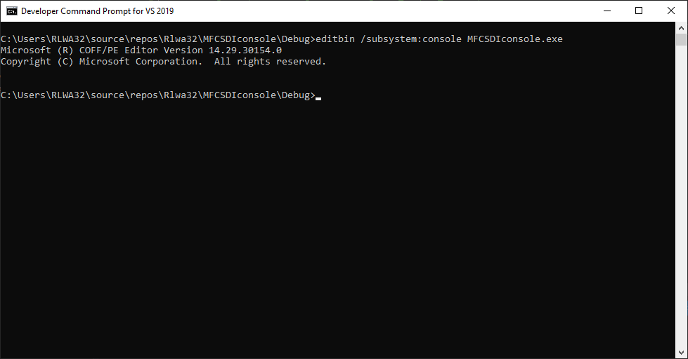

    After building the MFC SDI app use the VC++ EDITBIN utility to change the subsystem --
    Editbin
