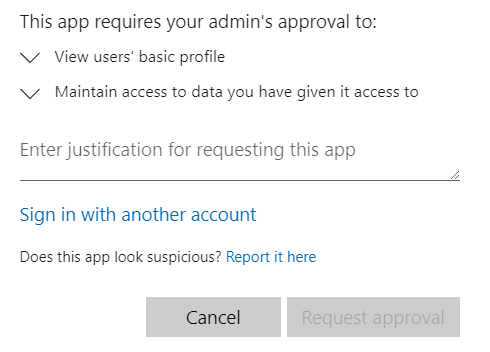

I have a similar problem like many people have when using App Registrations and Enterprise Apps: The login fails with a message requiring admin, even though you have things configured that a user should be able to consent Admin Consent
My settings all indicate that no admin consent should be needed.

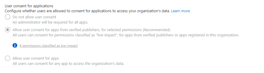

  1. The Tenant is configured to allow users to consent for verified publishers, for selected permissions. Consent Settings
  2. The Microsoft Graph Scopes for various permissions are classified as low. Classification

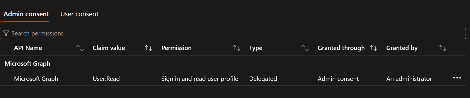

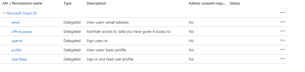

  4. My App Registration defines various pemissions as delegated and no consent required. API Permissions
  5. The Enterprise App has "Assignment required?" set to "Yes" as only selected users should have access.
  6. The Enterprise App has users and groups assigned with the "Default Access" (users directly in groups)

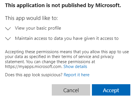

The users can consent themselves if "Assignment required?" is set to "No". But IMO that settings shouldn't influence the consent check. I want users to consent themselves assuming they are granted access by assigning them via users and groups.
Assingment Required No

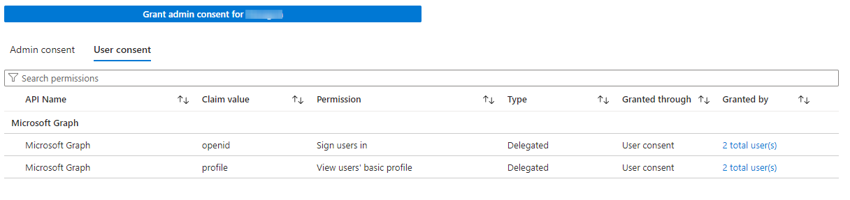

After login via "Assignment required? No" I see the User consent:
User Consent

  1. Vasil Michev 125.2K Reputation points MVP Volunteer Moderator
    2024-03-28T18:17:49.2+00:00
    You have correctly identified the issue here, the "assignment" functionality currently clashes with consent requirements. Microsoft is aware of this and will likely address it in a future update.
