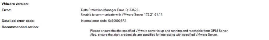

Based on the information you provided, I understand that you are trying to install MABS Server and communicate with the VCenter Sphere. However, you are receiving an error 33623.
Azure Backup Server uses TLS 1.1 by default to communicate with the ESXI host.
ESXI host version 6.7 only supports TLS 1.2 protocol.
To configure backup ESXI 6.7 perform the following:
· Enable TLS 1.2 on Azure Backup Server
Note: VMWare 6.7 onwards had enabled TLS as communication protocol.
· Set the registry keys as follows:
Windows Registry Editor Version 5.00
[HKEY_LOCAL_MACHINE\SOFTWARE\WOW6432Node\Microsoft.NETFramework\v2.0.50727] "SystemDefaultTlsVersions"=dword:00000001 "SchUseStrongCrypto"=dword:00000001
[HKEY_LOCAL_MACHINE\SOFTWARE\WOW6432Node\Microsoft.NETFramework\v4.0.30319] "SystemDefaultTlsVersions"=dword:00000001 "SchUseStrongCrypto"=dword:00000001
[HKEY_LOCAL_MACHINE\SOFTWARE\Microsoft.NETFramework\v2.0.50727] "SystemDefaultTlsVersions"=dword:00000001 "SchUseStrongCrypto"=dword:00000001
[HKEY_LOCAL_MACHINE\SOFTWARE\Microsoft.NETFramework\v4.0.30319] "SystemDefaultTlsVersions"=dword:00000001 "SchUseStrongCrypto"=dword:00000001
Also remove and add again the VMware account on the Azure Backup Server
*Communication should work between Azure Backup Server and ESXI
*Install the agents in the VMs
FYI: These steps should work for your set up and help resolve the issue. Feel free to write back to us if you need further assistance.
