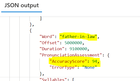

  1. santoshkc 15,435 Reputation points Microsoft External Staff Moderator
    2024-03-29T11:06:16.6066667+00:00
    Hi @Fine Sveta,
    Thank you for reaching out to Microsoft Q&A forum!
    The pronunciation assessment tool uses a phonetic dictionary to evaluate the pronunciation of words. The dictionary may not contain all possible variations of a word, including hyphenated words. Thank you for letting me know that you have discovered that the hyphen in the word 'father-in-law' may have been the cause of the lower accuracy score and that evaluating the audio file without the hyphenated word resulted in a good accuracy score.
    I tried to repro your issue with the given audio file that by setting the language as "English (United Kingdom)" and that it resulted in good accuracy (see below image). This suggests that the pronunciation assessment tool may be more accurate for certain languages or dialects. If you encounter similar issues in the future, you may want to try evaluating the audio file with different language settings to see if it improves the accuracy score.
    Hope this helps. And, if you have any further query do let us know.
    If this answers your query, do click Accept Answer and Yes for was this answer helpful.
