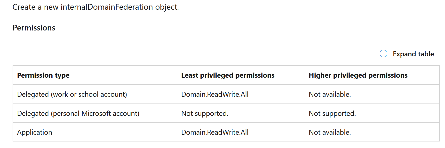

    I am assuming this is due to the personal/live account you have been using to authenticate. As per New-MgDomainFederationConfiguration permissions Delegated (personal Microsoft account) is Not supported and this requires a work/school account.
    Solution: Create a user within your Entra ID tenant and elevate it to global admin user and when prompted to authenticate to Microsoft Entra ID, use the credentials of this account as it would have Global Administrator role while running the PowerShell session script.
